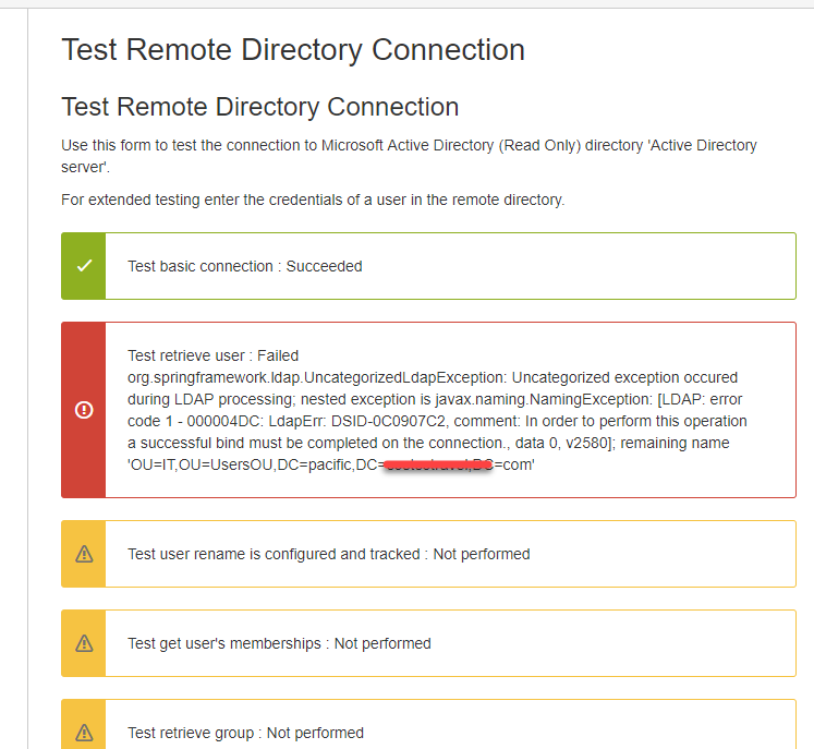

I'm trying to add a User Directory using our AD server. I'm able to authenticate and I'm sure the root is correct, but I get the following error when testing the connection.
Any help is appreciated.
i am getting below error too when trying to add User Directory. The error is almost the same except last part. Any help in this regard would be appreciated greatly.
Use this form to test the connection to Microsoft Active Directory (Read Only, with Local Groups) directory 'Active Directory server'.
For extended testing enter the credentials of a user in the remote directory.
Test basic connection : Succeeded
Test retrieve user : Failedorg.springframework.ldap.UncategorizedLdapException: Uncategorized exception occured during LDAP processing; nested exception is javax.naming.NamingException: [LDAP: error code 1 - 000004DC: LdapErr: DSID-0C0907C2, comment: In order to perform this operation a successful bind must be completed on the connection., data 0, v2580]; remaining name '/'For more information regarding LDAP error codes see Troubleshooting LDAP Error Codes.
Test user rename is configured and tracked : Not performed
Test get user's memberships : Not performed
Test retrieve group : Not performed
Test get group members : Not performed
Test user can authenticate : Not performed

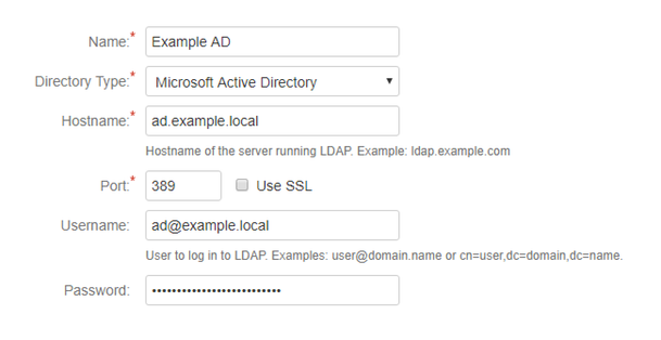

Here is an example from our lab.

Test retrieve user : Failedorg.springframework.ldap.UncategorizedLdapException: Uncategorized exception occured during LDAP processing; nested exception is javax.naming.NamingException: [LDAP: error code 1 - 000004DC: LdapErr: DSID-0C0907C2, comment: In order to perform this operation a successful bind must be completed on the connection., data 0, v2580]; remaining name 'OU=IT,OU=UsersOU,DC=pacific,DC=xxxxxxxxxx,DC=com'
