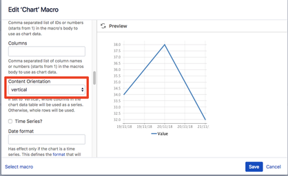

The table you presented is in a good format. The issue you are having seems to be related to content orientation of the data to display. If you adjust your orientation from NULL or Horizontal and set it to Vertical you should start getting data. Example as follows:
Something to also consider is to use the built in date picker within Confluence to ensure your data formats are standardized. To enter the date picker simply press // and you will be presented with a date picker. Here are additional Confluence keyboard shortcuts.
