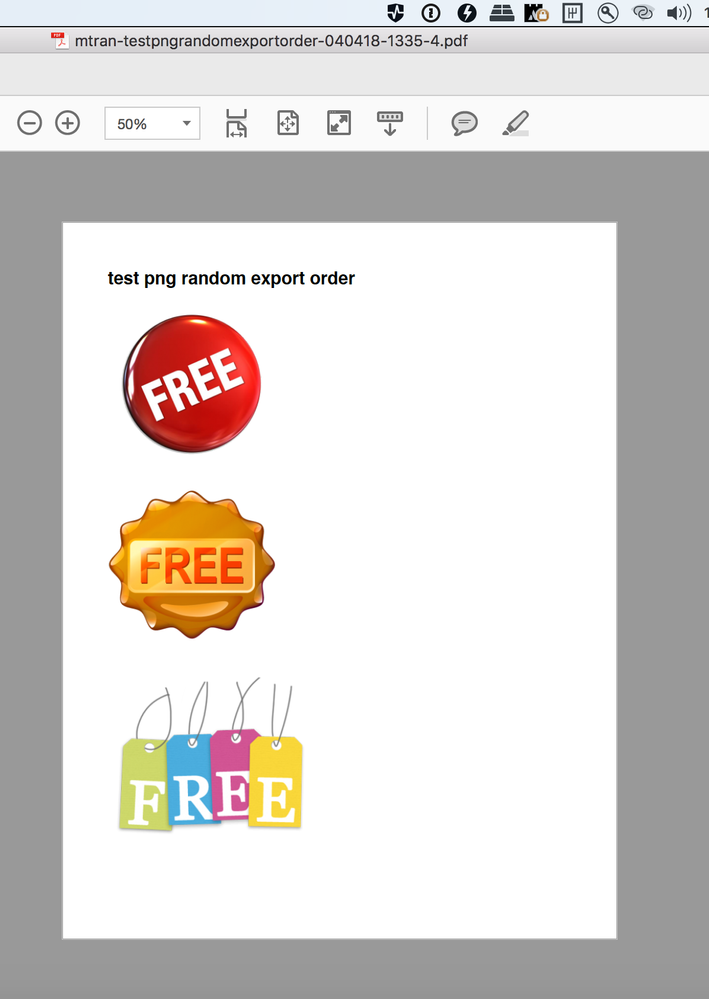

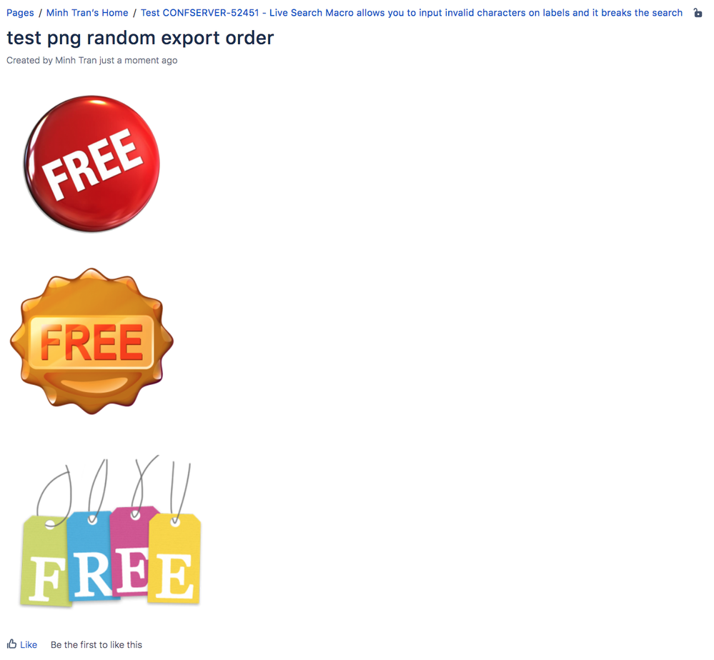

I am testing 2 cases:
First one is all 3 png files
Here is the corresponding export pdf

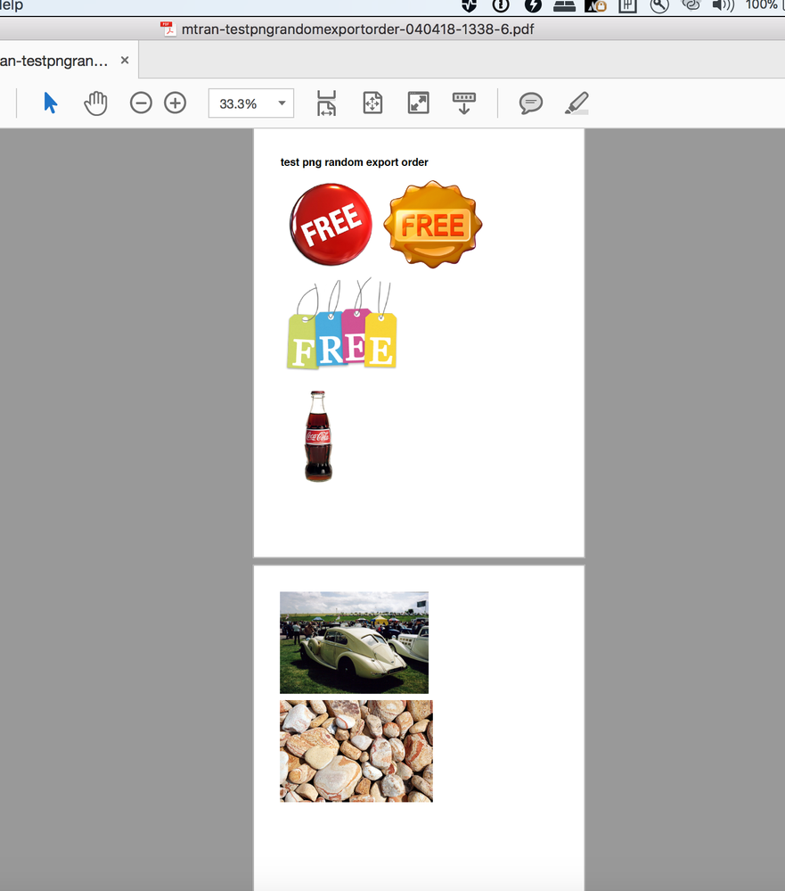

Another case is 3 png on the top and then 3 jpg next to those.
and the export pdf of that page:
Those look good to me in the Confluence 6.8.0+
