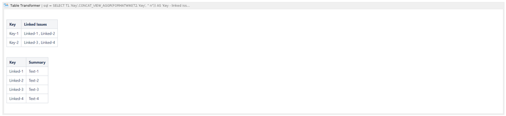

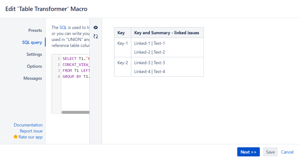

SELECT T1.'Key',
CONCAT_VIEW_AGGR(FORMATWIKI(T2.'Key', " | ", 'Summary', " \n")) AS 'Key and Summary - linked issues'
FROM T1 LEFT JOIN T2 ON T1.'Linked Issues'->split(" , ")->indexOf(T2.'Key'::string) > -1
GROUP BY T1.'Key'
Hope it helps.
