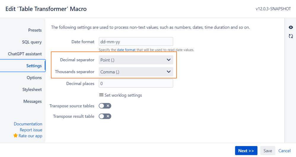

Then you go to the macro settings and set the delimiters:

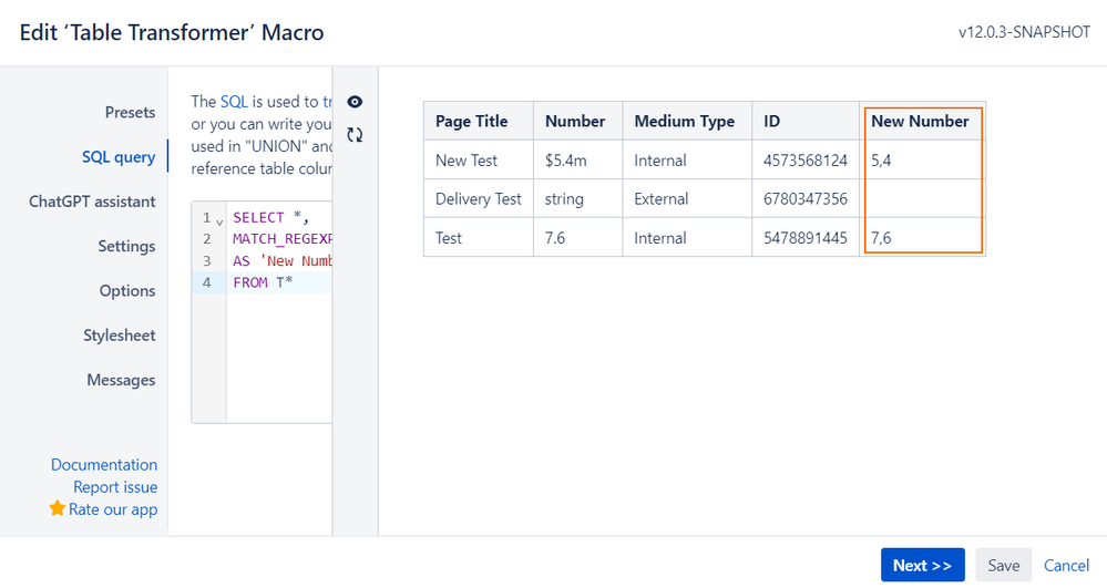

Insert the following SQL query:
SELECT *,
MATCH_REGEXP(T1.'Number', "\d+", "g")
AS 'New Number'
FROM T*
And get the following result:
Hope it somehow helps.
