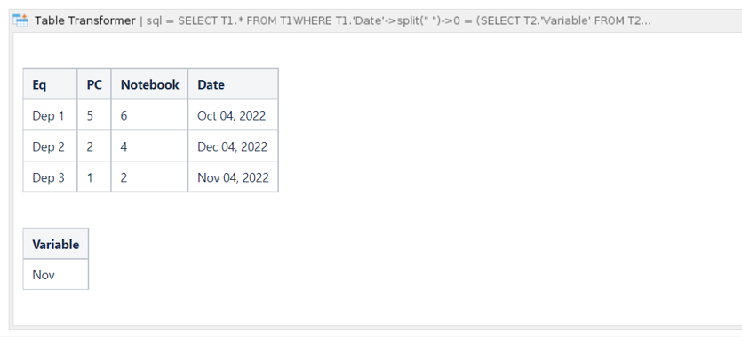

Maybe the following workaround will suit you: use the Table Transformer macro instead of the Table Filter macro for filtering.
Wrap your Jira Issues macro with a general JQL in the Table Transformer macro and then in the Table Excerpt macro to reuse the filtered table. So, later you’ll be able to use the Table Excerpt Include macro several times to create different charts based on the same source table.
To filter your table with the help of the Table Transformer macro, create another manual table with your variable (in our case it will be month in the format coming from the Jira Issues table):
Then we cut “a month part” from the date and compare it with our variable:
SELECT T1.* FROM T1
WHERE T1.'Date'->split(" ")->0 = (SELECT T2.'Variable' FROM T2)
By changing the variable, you will change the filtered table and all the reused tables as well.
In the previous option with the Table Filter macro you may also use the Table Excerpt macro after the Table Filter macro: set the date range filter once and reuse the filtered table for all the charts concerning the specific month.
