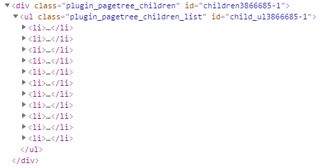

First you'll want to look at the HTML that is generated by the macro.
As you can see it is a UL with the class plugin_pagetree_children_list. Each direct child LI represents a top level item in the page tree. Using the selector .plugin_pagetree_children_list > li we can grab all of those:
var listItems = $('.plugin_pagetree_children_list > li');

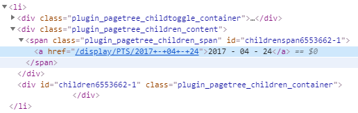

Once we got the LIs we need to look at the HTML again to find the node that contains the text.
As you can see these nodes have the class .plugin_pagetree_children_content and we only want the :first one because we are in a tree and there might be children. Once we have the text we can perform a check against it to see if we should remove the item.
