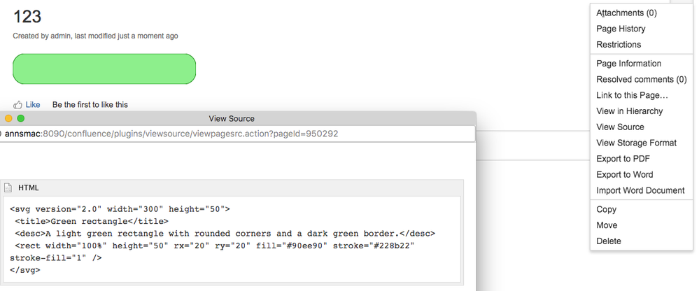

I did "View Source" after saving and it was still there:
Screen Shot 2017-05-04 at 2.55.24 PM.pngI will try on Confluence 5.9.8 and see what I get.
Michael Jordan May 4, 2017
Indeed, when you View Source from the actions menu within Confluence, the title tag will be there, because you are looking at the content stored within Confluence. However, when the published content is rendered in the browser, if you use the browser's View Source, the title element will be missing.
