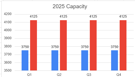

What we currently have in Excel looks something like this, with blue being what would be the sum of the weighted minutes field, and the red our capacity.

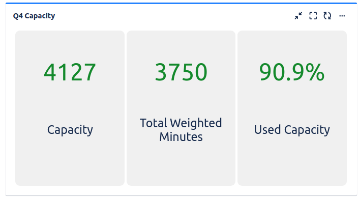

If you consider the idea of using a plugin, our Great Gadgets could be helpful because it offers some gadgets that can display this type of info.

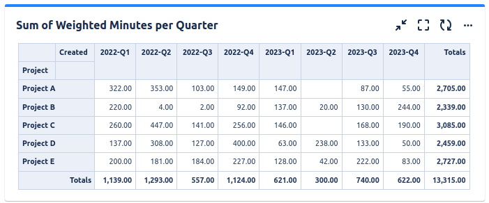

Advanced Issue Filter Formula gadget - this gadget lets you sum-up a numeric field (like Weighted Minutes) for the issues in a filter. In addition, it can calculate percentages, so you could use it to display capacity vs planned for a quarter.
Pivot Table & Pivot Chart gadget - can sum-up your Weighted Minutes field for the issues from a filter, and split it by project and quarter (based on a date field, like Created). It works like pivot tables from Excel.
