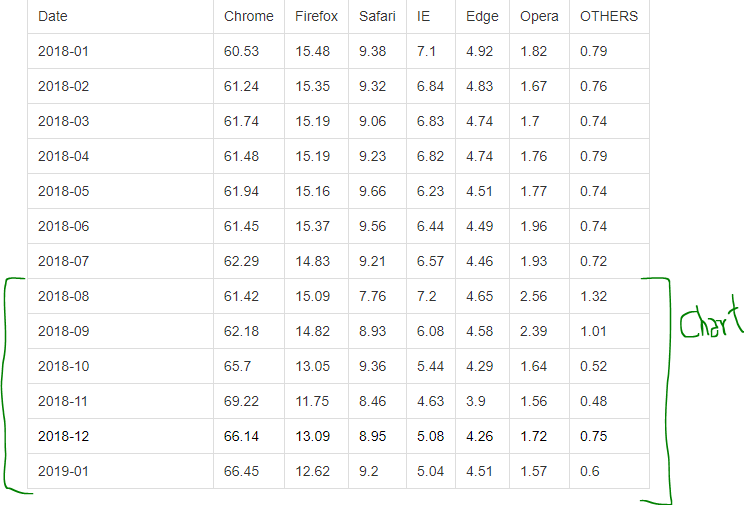

I want to have a complete table, but I don't want to use all the rows data to build it!
Example I've the table above, and I want to build a Chart with the last six rows, is this possible?

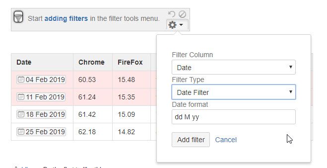

Thanks for posting this question. To build on @Gasalho Antero's answer, here are the steps to complete your request:

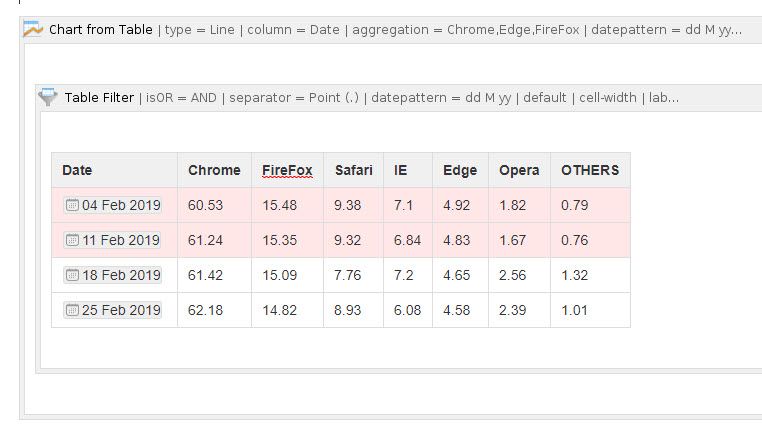

1: Wrap your table in the Chart From Table macro and Table Filter Macro.
Goal: Only expose the last 2 lines of information in the chart.

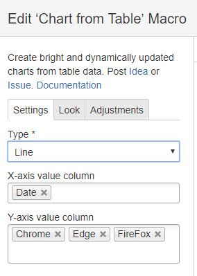

2: Edit your chart. Date = X, Web Browsers = Y

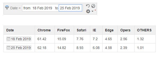

3: Add a filter onto your page for the date range
4: Insert a date range
Your chart will then adjust as you change the date ranges.
