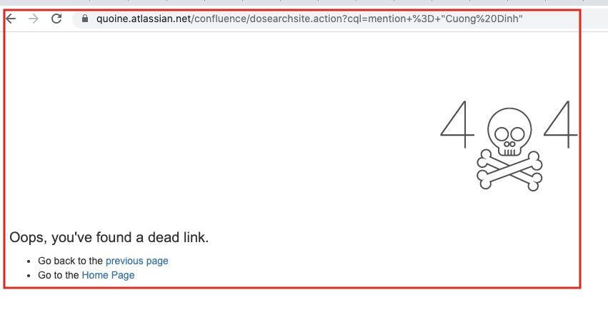

Hi @Hoa Nguyenthi , you replaced YOURURL with your url and INACTIVEUSERNAME with the username of the inactive user, correct?
If so - is it possible that there aren't any results because that user is not mentioned in any pages?
Without knowing the details of your case, I'm not sure why it isn't working, but those are the first two things I'd check.
@Hoa Nguyenthi It looks like that may be the user's full name, instead of a username. Does it work using the username, maybe something like cuongd1? I can't access an Atlassian Server instance right now to confirm this, but I think that you can view details even for inactive users in user management.
Hi @Hoa Nguyenthi,
It looks like you're using Confluence Cloud - the link above works for Confluence Server.
I tried the format below on Confluence Cloud, and it seems to work:
https://YOURTEAM.atlassian.net/wiki/search?cql=mention="ACCOUNTID"
The account ID is a long string that includes a colon and several hyphens. It's visible in the URL when you're viewing a user profile. I'm not sure if it's possible to view profiles for inactive users... in case not, there are instructions in this post for getting the account ID programmatically:
