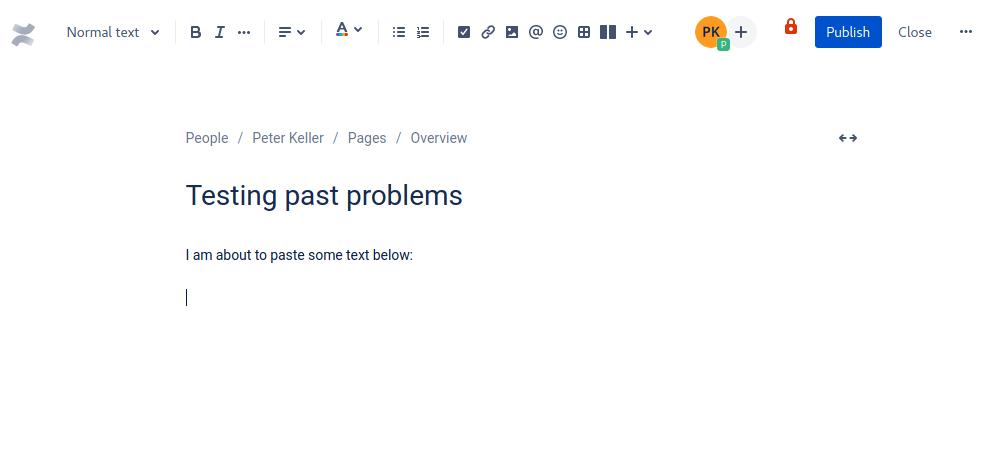

  1. Just before pasting text

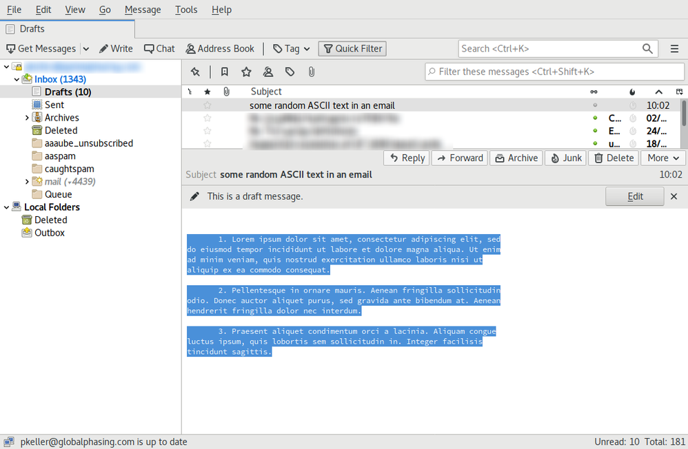

  2. Source of copied text (the screenshot shows Thunderbird, but the draft text was created with Alpine)

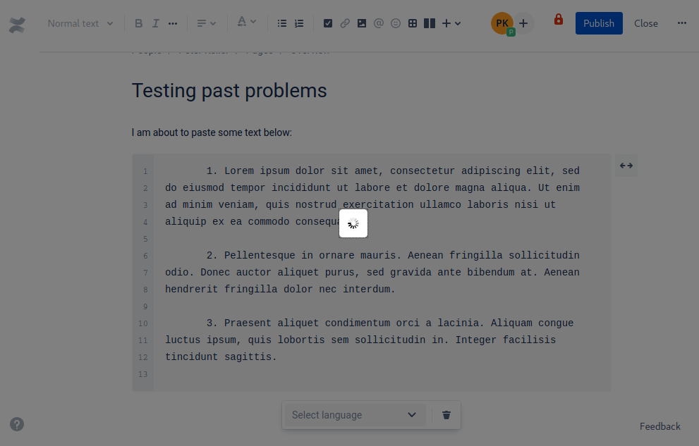

  3. Just after pasting text

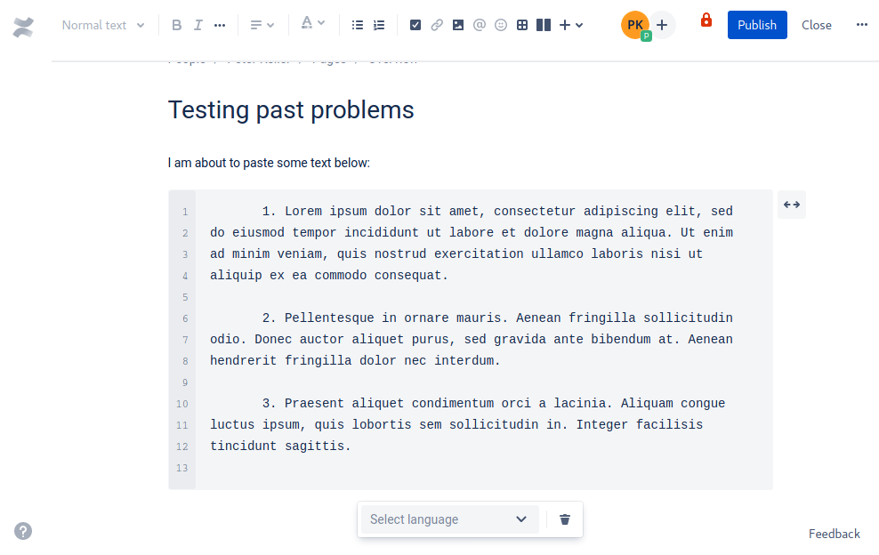

  4. What happens if I click the feedback button to point out the problem :-(
Note that even if I did want to paste something as code, I don't have any control over the starting line number (unlike in the old editor). The hang when I click "Feedback" is just adding insult to injury: the only way out of this is to kill the tab and resume my work from "Drafts". There is so much going wrong here that it is difficult to know where to start. Frankly, I can't conceive of any circumstances where I would use Confluence for a new project, or even suggest to anyone that they look at it.
