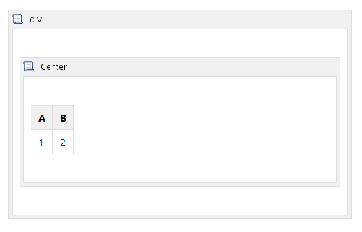

Something like this works usually but it's butt ugly in the editor. The Center macro from Adaptavist's Content Formatting macro's would probably be better.
