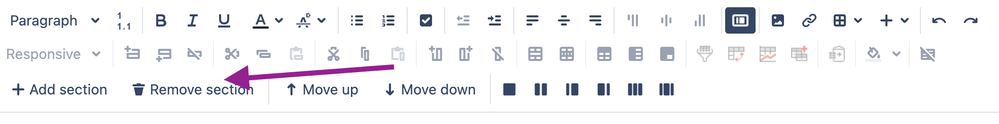

Click on the "page layout" button to get the section menu to drop down, click on the section you want to kill off, then use "remove section" from the menu
Yes this works perfectly, thank you.
Took me a second to find the "Page Layout" button, for those similarly blind:
