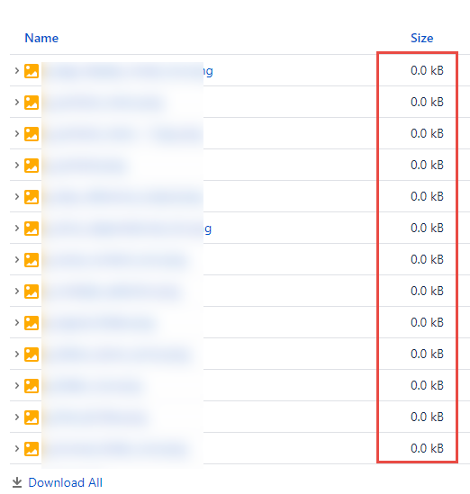

After I delete an attachment via REST API, when I upload the same attachment via API, the request is successful - I get a 200 response code. However, there is no data in the attachment and it cannot be previewed. Any any idea why this is happening?

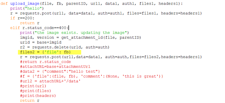

@Diego  my code for creating the page and uploading images to  the page works fine. I also figured out how to update the attachments. However, I do not want to keep updating the attachments since that creates multiple versions of each attachment. So in my code, I check if a particular attachment exists. If it exists, I delete the attachment and then try to upload the updated attachment. After I delete the attachment, my code for creating the attachment works. However, as shown in the image, the attachment files lose data and cannot be previewed - after deleting the attachment, when I upload the attachment their size is 0.0 kb.
antony terrence
April 23, 2019
@Diego  I kind of solved this with the highlighted line. Thank you for your help.resolved.png
