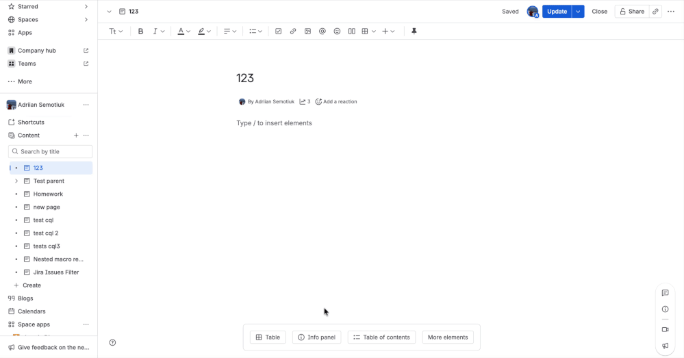

Welcome to the community, I am developer in Wombats Corp. I have also tried to make "Insert Confluence list" macro work , but the same query that was working in http request , wouldn`t work in the macro.
As a workaround for your issue, i have created this "List of pages in space" macro using our app User Macro for Confluence Cloud .This macro adds a list of pages from chosen space, and has a filter for both Title and Label.
Currently this macro has columns Name, Last Update Date, Created By and Labels. Any other columns can be added if necessary.
