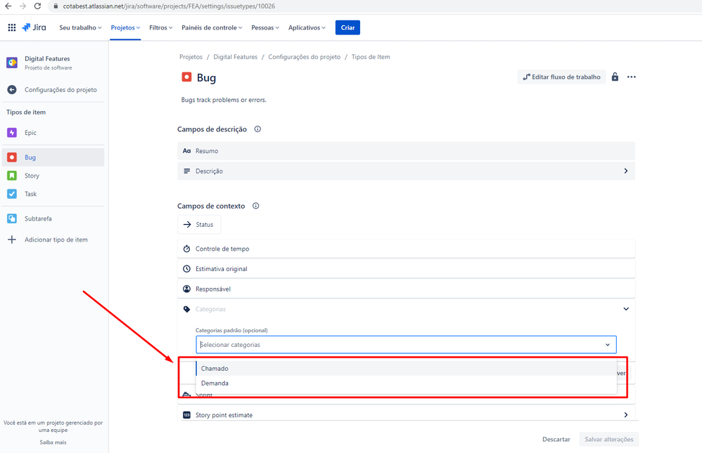

How can I edit the value of this label field, I want to change the name "Chamado" to "Atacadão" and "Demanda" to "CotaBest"

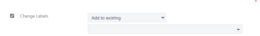

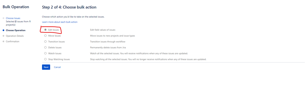

Hello @Alvin Leroy Steagall ,

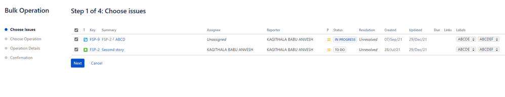

1. First Find all the issues with the Label =Chamado --> Project ="project Name" and Label =Chamado
2. Bulk operation
3. Edit Issues
4. Select Change Labels --> select "Add to existing"

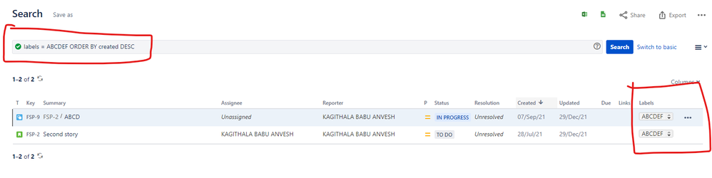

add the new label as "Atacadão"
Save changes and do the bulk edit.
after adding the JQL showing as below

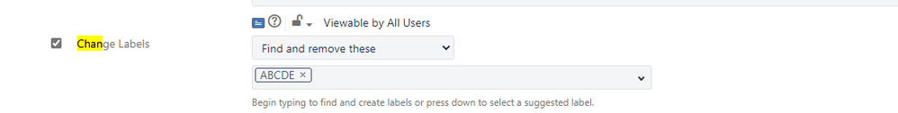

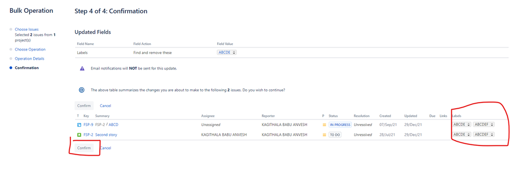

Now again  do "bulk operation"
choose the above settings

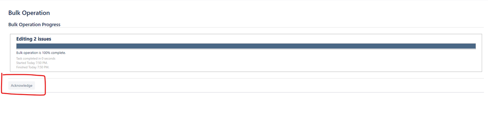

Click on confirm
Acknowledge as the above.
Now you can search with Old Label, No results shown and try with the new Label as above you will able to see with the same two issues with the new label.
I hope the above helps you.
