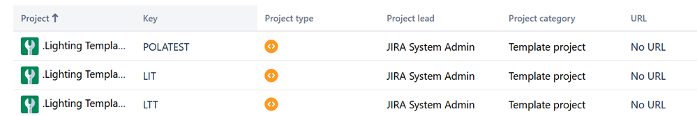

I have a question regarding one small usecase
My customer wants to me fetch few more column details under all project section of JIRA Software, so that he could apply filter inorder to know status and other stuffs
As you can see in above picture, as of now only few columns are visible, now my customer wants some more columns like Project lifecycle (open or close), Project ID, customer information, but as far as i know its not possible to do so, so instead i am thinking something like what if i provide a confluence link under URL, which leads me to a confluence page where it will contain table with heading like customer, project lifecycle status,.. etc and then maybe using easyBI i can show him the list of all project along with values like project lifecycle status, customer,..etc so i just wanted to know whether this approach is possible can i fetch the data from confluence table rows and column in easyBI? or is there any other approach you would suggest me get this done?

Actually not my customer does have access to our JIRA Environment but the thing they are not regular user of JIRA, they are someone from top management who just want to see some project data like budget, end customer, is it a SW or HW based project, status, project lead etc.. just like it is shown in Projecttrak, but can't we bring similar kind of column settings in JIRA software instead of using ProjectTrack?

Thank you very much for quick response, but problem is when we create a new JIRA Project, by default we get very limited options like project name, project key and category but my end customer wants me also to add some more information like project status, who is the customer and few other parameter, i hope you got what i want, so could you please suggest where can i put on these detail while creating a new porject on top level, so that when i hit the api, these details should also come along

To make you understand in more clear way, you can see Dave has shared a link to A third-party app which he used in the past on Server/Data Center is Projectrak,
Now you can see in Projecttrak, they have some additional custom column like budget, description,... and on top of it they could filter on that as well,
Can i achieve the same in JIRA as well, can i bring custom column against each JIRA project to add on few more details, so that our management guys can see the complete detail from the top level
