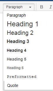

The factory set of styles is available in the style drop-down menu within the Editor and is limited to 9 preconfigured styles only.
I'd like to exend the set of styles with my custom styles.

So to wrap up, there's nothing how I could add or extend the style set to make them available in the drop-down list, correct? Instead, I can only modify the look and feel of pre-configured styles.
Did I get it right?
Thank you.

While I agree that customizing or extending this menu would be nice, there are several options for preformatting and coding, as follows:
  • Preformatted style, as shown in the OP's screenshot. This is useful for quickly applying a monospace font to a paragraph.
