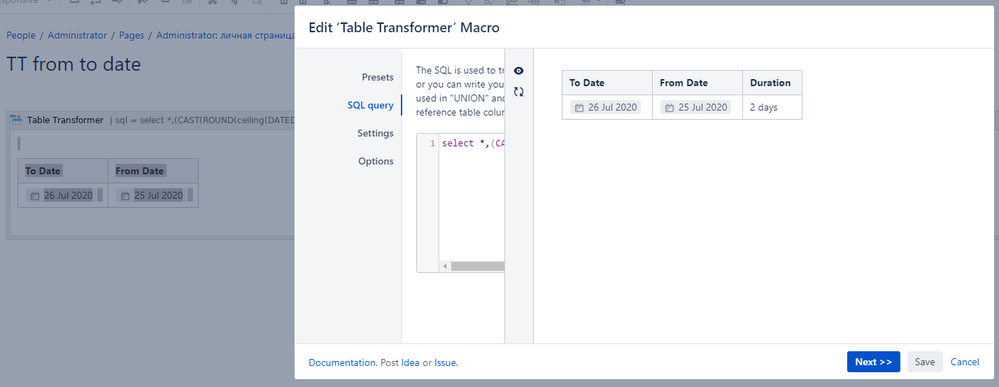

Hi @Gireesha Jeera, I used your query in the Table Transformer macro and it works as expected:
What version of Table Filter and Charts do you use?
Did you set the correct date format dd-M-yy in the macro settings?

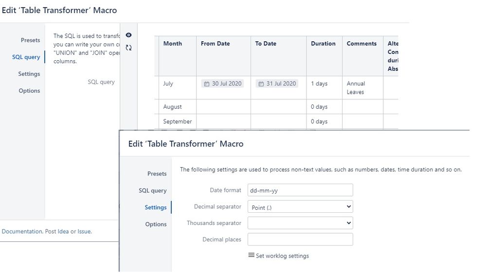

Thanks for the quick response, in my case table looks as below:
for me this still displayed as 1 days, can you please help here ?

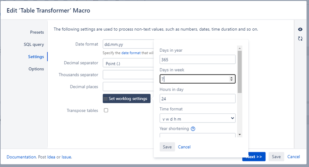

select *,('To Date' - 'From Date' + "24h") / "24h" + " days" as 'Duration' from T1
Please, try this. By default "1d" equals to 8 hours (working day). You can change it in the Worklog settings:
Gireesha Jeera July 27, 2020
@Andrey Khaneev _StiltSoft_ Perfect works mate, thank you.
