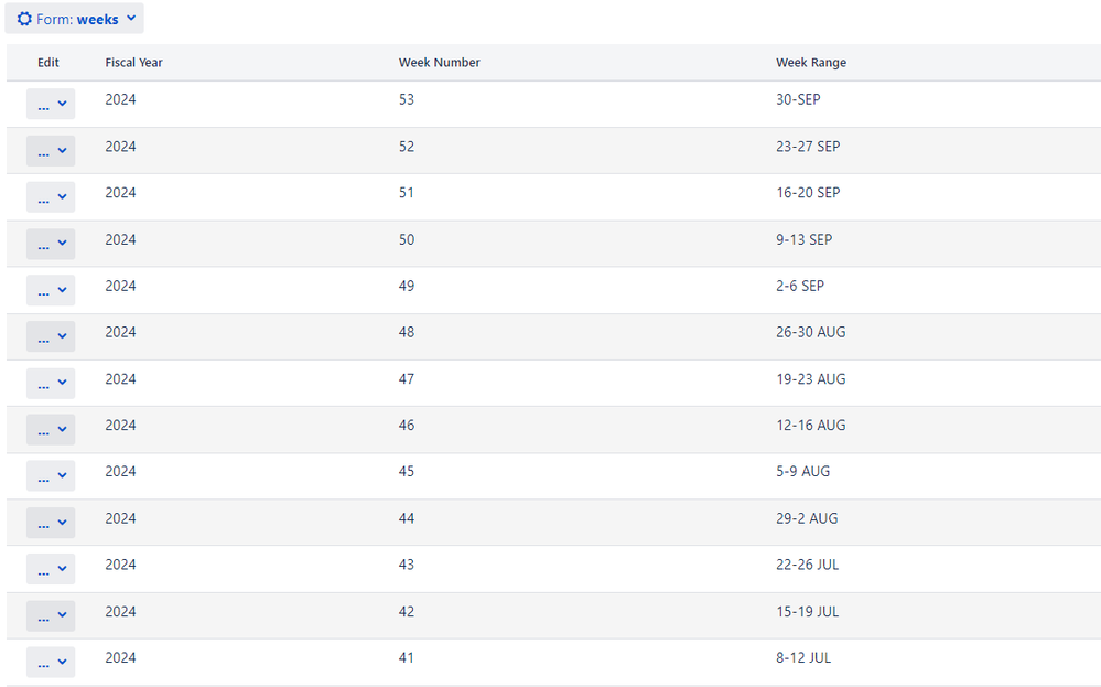

I have a ConfiForm full of fiscal years, week numbers  and text for each week that I want displayed on a smart dropdown.  Right now, I have all of the weeks for FY 2023 and FY 2024 in there.

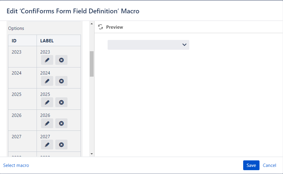

I also have a dropdown with the fiscal years hardcoded in the dropdown:

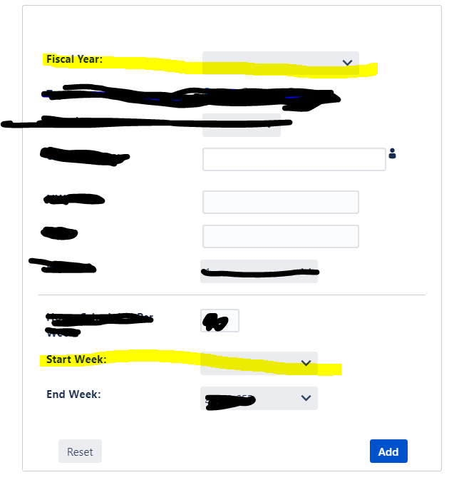

The Fiscal Year is at the top, and the Start Week and End Week are in a 2nd div that is hidden and unhidden based on the next value, which is a radio button.  Is it possible to use a smart classifier when the dropdowns are not sequential?  According to my colleague, it's not.  This is what my registration form looks like:Registration form.PNG

Not sure what do you want to show with this screenshot, but your colleague is right - the smart classifier field cannot be split into multiple pieces. It is just one field - it can be rendered as an N number of (cascading) dropdowns (selects), but it is still a 1 field.

Sorry to have blacked out so much.  The user selects the fiscal year.  The next field is a radio box which I'll call, "type."  Depending on "type", the bottom div will display or not display.  The Fiscal Year is relevant for all types.  The Start Week and End Week are only relevant for 1 type.
Yes, the 2nd method you had recommended is the one I was going with.  I wasn't able to get it working.  Perhaps my filter is incorrect.  Or perhaps I need to put the years in their own form rather than having them hardcoded.  I can do that, but the value and text are the same: years 2023 thru 2030.  However, I doubt they'll be using this software beyond FY 2026.

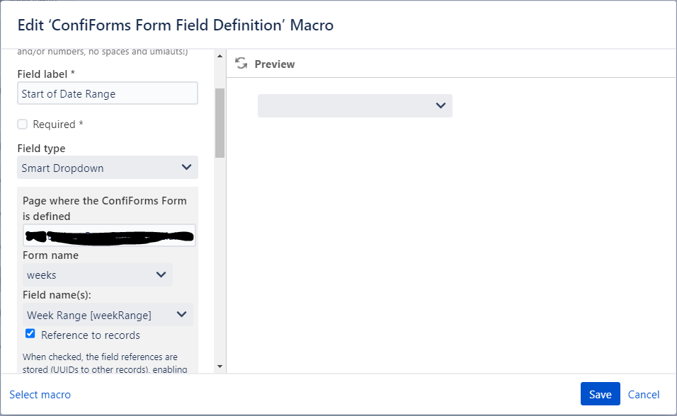

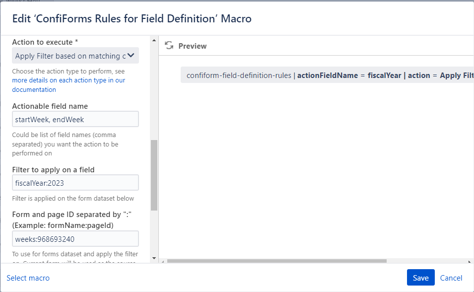

The field names in the weeks form are fiscalYear, weekNumber, weekRange, and uniqueId (I don't use uniqueId yet).

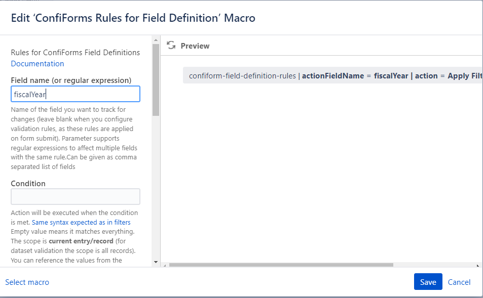

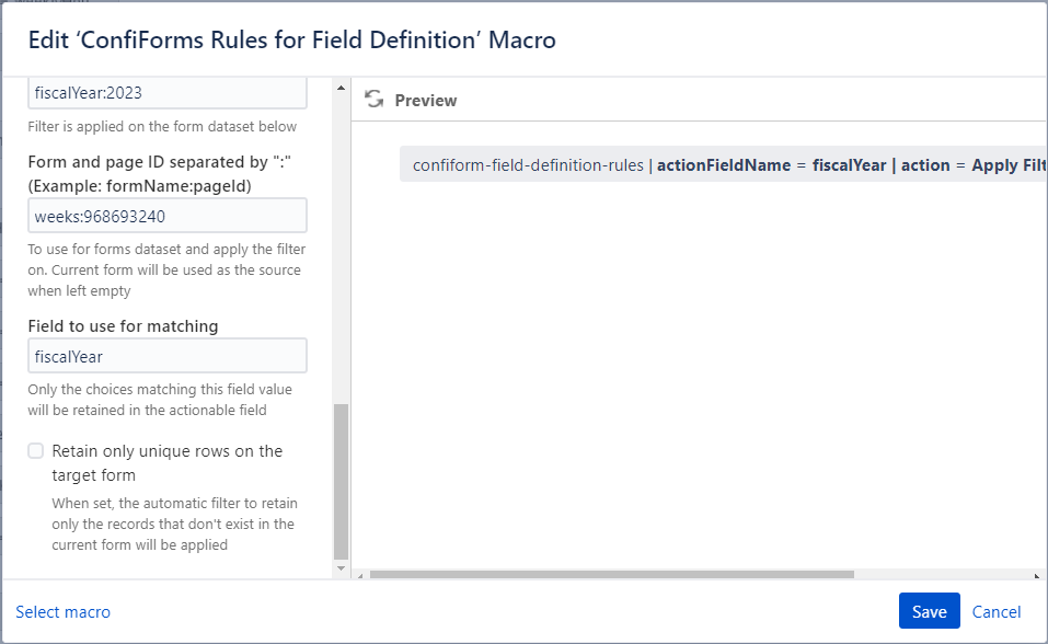

The filter is in the ConfiForms Rules for Field Defintions for fiscalYear, below:
Confiforms Rules on fiscalYear 1.PNGConfiforms Rules on fiscalYear 2.PNGConfiforms Rules on fiscalYear 3.PNG
I think the problem is that I'm not linking this rule to the definiton of startWeek.  How would I do that?  I tried a number of different scenarios last night, and I don't remember them all.
Thank you!
-Kathleen
Alex Medved _ConfiForms_
June 6, 2023
Hi
I was talking about this Field Definition Rule - https://wiki.vertuna.com/display/CONFIFORMS/ConfiForms+Field+Definition+Rules#ConfiFormsFieldDefinitionRules-ApplyFilteronafield (Apply Filter on field)
Here is the demo of what I was trying to suggest
http://recordit.co/3hPgVaNP8t
Alex
Kathleen Janiszewski
June 6, 2023
Alex,
Yes!  That got it working!!!  Thank you for your help!

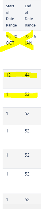

I still need the dropdown to store the week numbers, not the test on the labels.  I expect it to work the same way a regular dropdown works.  My code is completely dependent on week numbers.  See below:
June 7, 2023
I don’t quite understand this.
Smart fields store a reference to a record… which can be used to get any fields in the form that it references…

Thank you.  My colleague helped me to get the data I needed from [entry.startweek.weekNumber]

Yes, that is what I was trying to hint at - you can use smart fields as a "bridge" to jump to the values/fields that it is referencing in the other form
