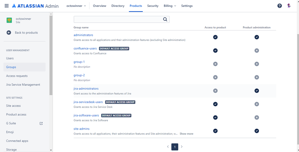

Check under these groups once

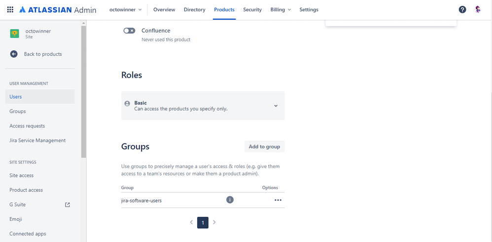

Under Each User check the group they are in

FYI,
They should not be under administrators, site-admins.
Subhas Acharaya - TCS February 5, 2021
So Pramodh,
You are suggesting that it could be an access problem that is preventing us to get the content of the attached files in HTTP GET request of a wiki page?
Pramodh M
February 5, 2021
Sorry got confused with the wrong Post!
Or you mean to say that some user who is in an administrator group will have this issue? whereas an user who is not in administrator group will get the content of attached files in the first HTTP GET call itself?
