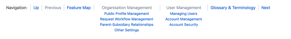

Here is an example of how I used the macro do a static horizontal navigation menu:
Custom Styling.pngThis is essentially a table which is edited with the standard editor of Confluence.

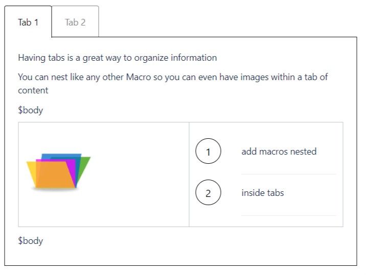

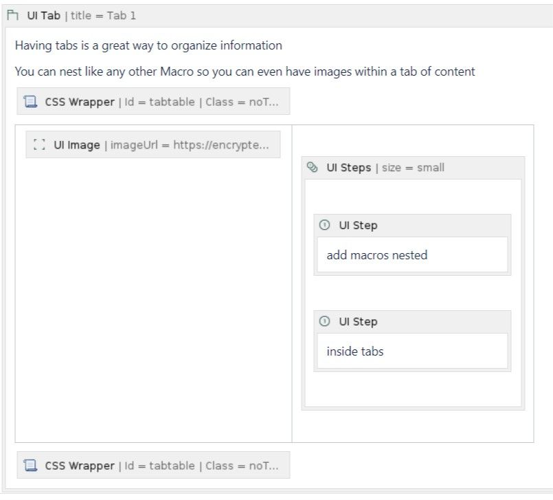

Lopes, Bonnie
June 28, 2021
@christianvecchiola , thank you for responding, I am having difficulty know where to place the wrapper and how to nest my table.  So I am just trying to remove the lines for the table that sits with a UI Tab macro. But the wrapper doesn't seem to let me nest other Macros in it. The UI Image and Steps are in a table.  It is this table, I want to remove the table lines, so the image and the steps float within the tab
When rendered, if just inserts $body
