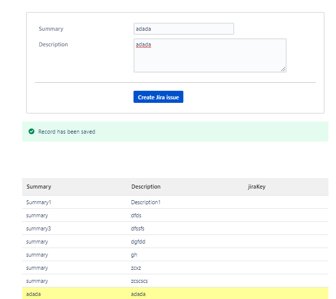

Thanks for your early response... my issue is whenever i submit a form in confluence page, it should populate an issue in Jira but on submission it is not creating any issue in jira. It shows the data which is updated through form. Even it is not creating the jirakey/Id. Moreover we are not getting any errors after submitting the form. In ConfiForms IFTTT integration rules, i selected the action item as "Create a Jira issue" and server as "Jira-server", etc. But it is not working....

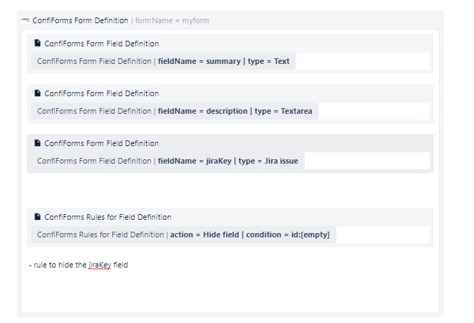

For your reference, Im attaching the screenshots of my form...

Please put JSON mapping you have into the "code" macro (wrap it into the code macro)
Also, when using new Confluence editor please set the form name parameter for ConfiForms IFTTT macro to link it to the form
