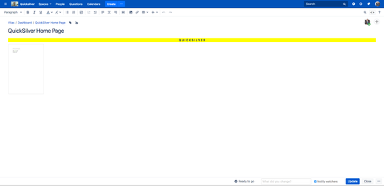

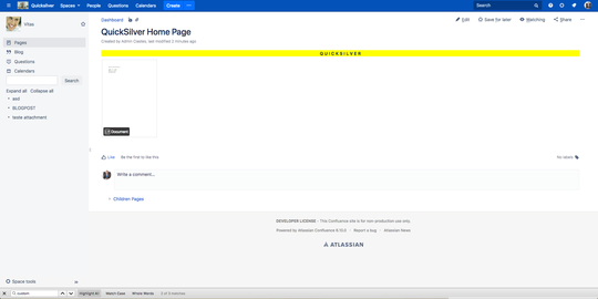

This banner will be visible Site Wide and also in Edit Mode! Here are a few screenshots of the results:
Screen Shot 2018-09-11 at 12.37.35.pngScreen Shot 2018-09-11 at 12.37.52.png

Some screenshots of the results:
Screen Shot 2018-09-11 at 12.48.57.pngScreen Shot 2018-09-11 at 12.49.08.png

I really appreciate your time! We definitely do not want a site-wide banner, it would just apply to specific pages. I applied the banner to a specific page and it worked as advertised. However, the banner still disappears when scrolling down the page. Is it possible to make it sticky even when there's more than one section on the page?
