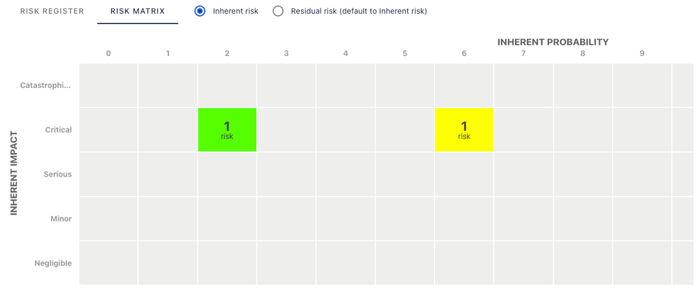

I would like to get the risk matrix available in Jira (inherent risk + residual risk) and store it on a confluence page.
I didn't found how to do it yet. Do you have suggestions or recommandations ?

It's Risk Register.
This is the matrix I try to get in confluence.
I have search for a moment on Risk Register documentation and my problem may come form the registration of external gadgets.
The problem is that I don't have enough privilege to check this configuration.
I contact my admin to control the config.
Thank you for your help !

The admin give me the access all rights to check the configuration.
I am facing another problem : I don't have the possibility to record external gadgets.
It looks like matching this topic.
To summarise it quickly, under Confluence cloud and according to this post the external gadget is restricted under Cloud.
I can find documentation on how to add external gadget for Data center and server but nothing on Cloud side.
Is there a way to record external gadget under Cloud ?
Thanks for your help
It is not currently possible to add the risk register gadget to Confluence in the cloud. This is an enhancement in our backlog, though I don't currently have a delivery date I can share for it.
