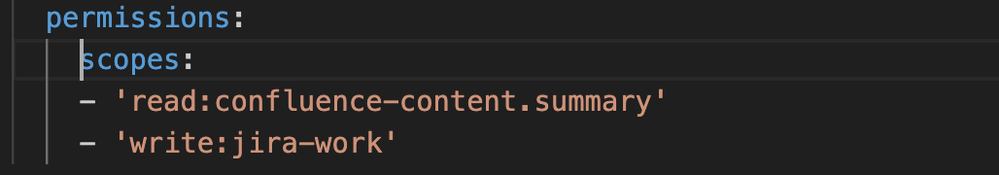

Yeah for Forge apps, you need to add some additional permissions and scopes
Now for Confluence, all of the scopes you can find on this page: https://developer.atlassian.com/platform/forge/manifest-reference/scopes-product-confluence/
Heyy @Nikola Perisic ,
Have updated the scopes you have mentioned in the manifest of Forge app, and deployed and installed the app on both Confluence and Jira.

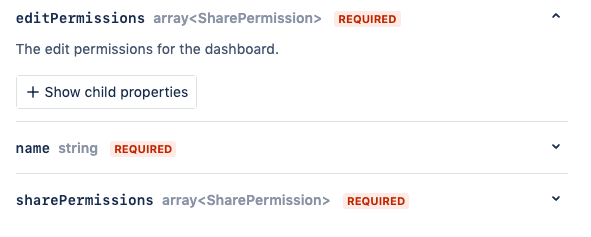

In the logs I see the 403 forbidden access. Not sure why is this showing to you. Also another thing
You need to fill out these required fields (expand the arrows for required fields). Another strange thing is that it isn't asking for an API key, so how does it know where to create the dashboard.
Have you tried using python instead? Since it asks for API key, which seems reasonable.
If you have trouble, I would also recommend using Postman, it helped me to create a dashboard.
