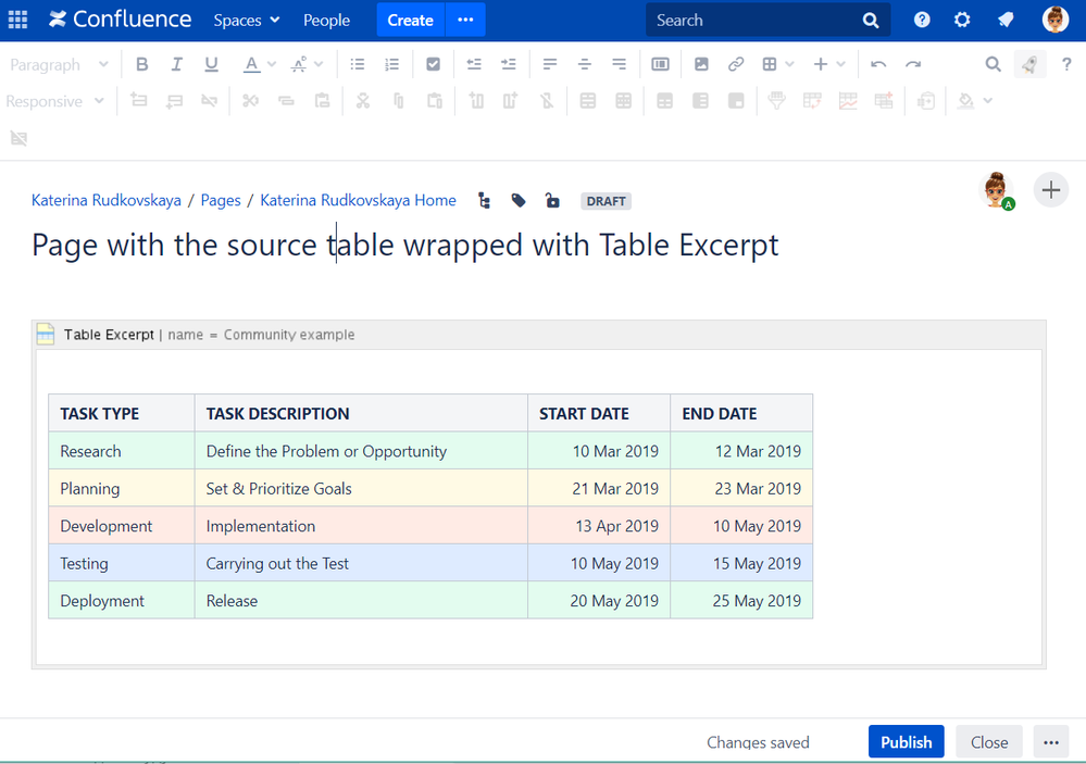

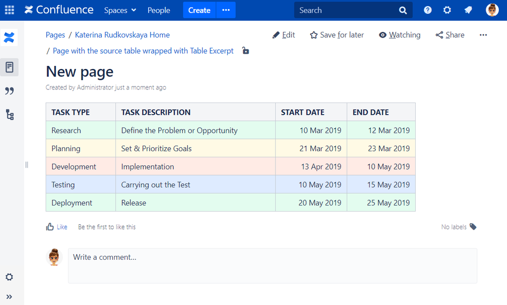

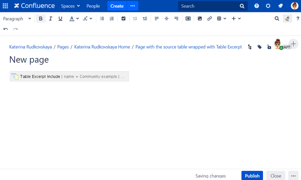

There are Table Excerpt and Table Excerpt Include macros in the Table Filter and Charts for Confluence app which could help you in this case.
Here's an example on how to use them:
1. Wrap your source table with Table Excerpt.
2. Insert the Table Excerpt Include macro on another page and configure it.
Result: the same table are ready for filtering, building charts, pivot tables and transformation on another WIKI page.
