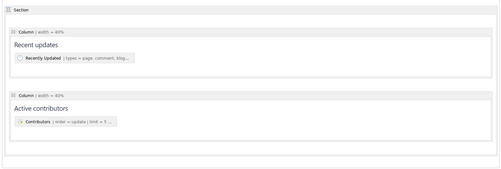

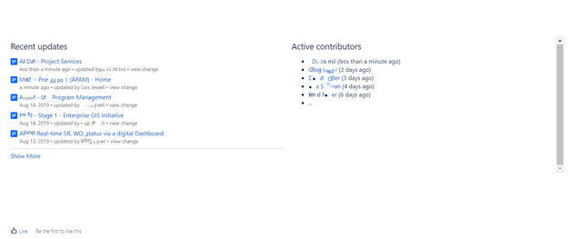

I'm working with sections and lay outs and currently I have a problem with a vertical scroll bar. Scroll bar appears every time when I use page lay out (2 column section) and insert tables. I would expect that section will enlarge dynamically. I'm also attaching an example, one edit view the other published view.
I would like to remove the scroll bar. Do you know how can I do it?

That is interesting that you're getting that vertical scroll bar. I typically see sections like that behave as you said they should – they expand vertically to fit the content. I also wasn't able to reproduce the scrollbar behavior when I created a page similar to the one in your screenshot.

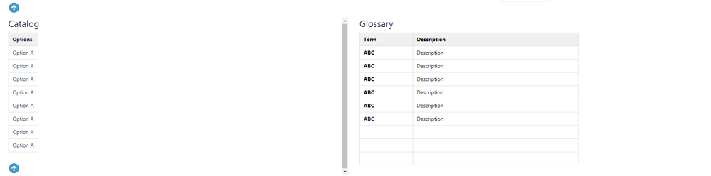

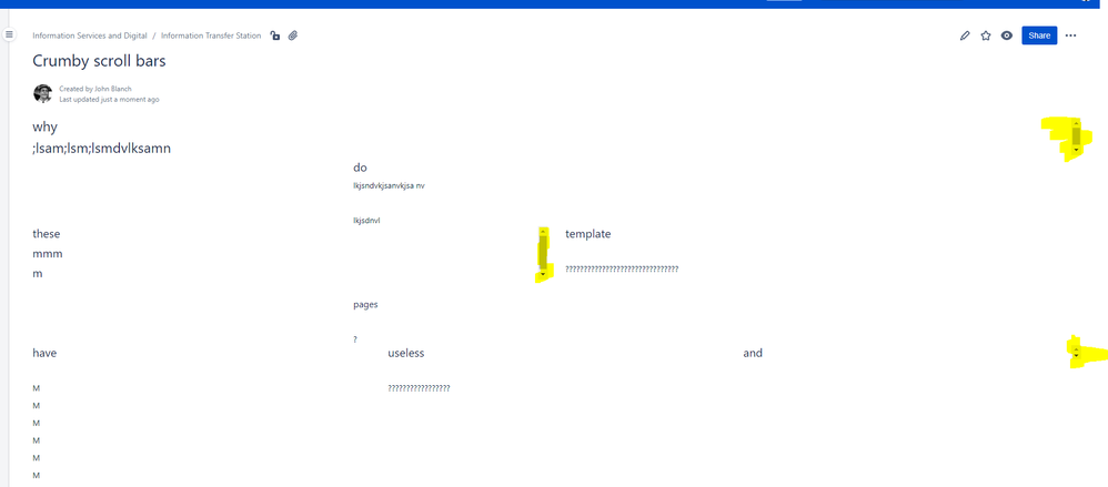

I'm experiencing the same problem. When I use headings at the top of sections in a template I get these vertical scroll bars that do not appear to perform any useful function, but they do make the page ugly and confusing. I've attached a pair of screenshsots - how the page looks and how the page is formatted.

I've also noticed this quite a bit lately. Leaving the last line within the column in a paragraph rather than a heading format doesn't seem to make any difference for me. I was wondering if it may be related to whether a column contains other macros as opposed to plain text? I haven't quite been able to land on the right combo of factors to consistently re-create the issue though.
I've attached a few screenshots (some edits and to obscure identifying info) a section of the storage format below.
