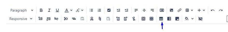

 Is there a way to add a numbering column to the table? Per the 5.8 release (https://confluence.atlassian.com/doc/confluence-5-8-release-notes-744325370.html#Confluence5.8ReleaseNotes-Hugewinsformassivetables), there should be a setting with an option to enable 'Insert Numbering Column' but I don't see it in mine. This is my view, should I be navigating somewhere else to enable this feature? The screenshot of my

The numbering column is the icon just before the fill-in icon, the black square with the white square on the bottom right>
On my side the column are sticky by default in read mode but not in edit. Is that what you are referencing to ?

Ahh ok...Got it. Thank you.
