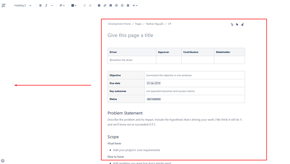

Hi!
Currenly all page content in my confluence is center align.How do I make it left align for all page in my space.
Thank you

Since this is so unintuitive, it took me a few seconds to figure out what you were talking about. Here's a screenshot to help everyone else find it a little more quickly:
thanks for the screenshot! :)
Still in the centre of the page :( I'd appreciate to be able to align it to the left of the page

Are you talking about being centered in a browser window? They way nearly all web content is now?
The issue for me is that we are not effectively able to use the screen-width. For example, I frequently have tables embedded in my page. Tables are an easy way to present information in a very consumable way. I also find I have to make the tables wider since I have 5+ columns, some with "comments" type content.
So you end up with a page that looks very strange with narrow content, then wide content (tables), then narrow content. All center aligned.
I'd like to have control over the width of the page, and how my content is aligned.
very little web content is centred where there is also a left hand nav that is separately left aligned, and other elements on the page which are full width (ie. comments)
Agreed, the whole page should be left aligned and then allow you to configure whether the page is fixed width, wider, or full page width. It's odd having a big gap between the page and the left nav.
