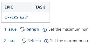

Result of the Initiatives/Epic join (perfecto!):
Result of the Epic/Task join:

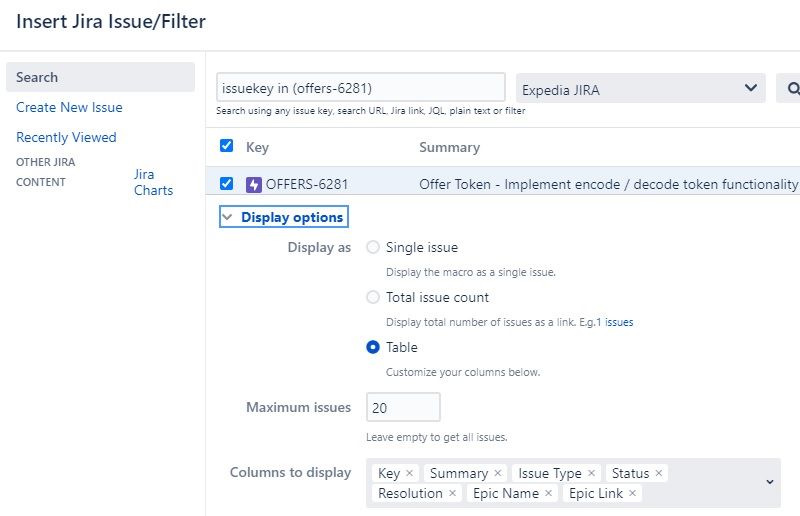

Ah - your question solved my dilemma. I had incorrectly assumed  that T1 had Epic objects and T2 had issue objects, but I had failed to consider the columns defined by the display options of the Jira/Issue Filter I was using to create T1 and T2. Including Epic Name and Epic Link in the display options as columns for T1 and T2 obviously resolved my quandary. Thank you!

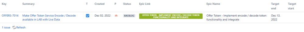

@Stiltsoft support  Hello! I thought I had solved this yesterday, but I must have mis-poken.

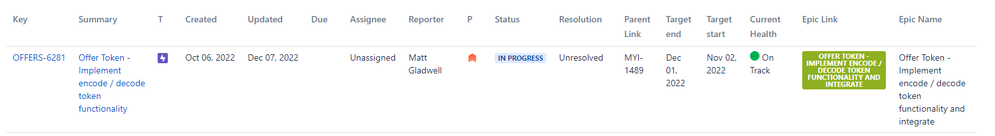

Table 1 is a Jira/Issue Filter that returns one epic:
Table 2 is a Jira/Issue Filter that returns one task:
Sample output with the SQL Query "SELECT * FROM T*":
Sample output with the SQL Query:
SELECT T1.'Key' AS Epic, T2.'Key' AS Task
FROM T1
LEFT JOIN T2 ON (T1.'Key' = T2.'Epic Link')
GROUP BY T1.'Key', T2.'Key'
I have almost the exact same Table Transformer code working with Initiatives and Epics, but can't figure out why this isn't working. :( Any help appreciated.

@Stiltsoft support - I'm confused. I provided screenshots of the tables above. ^^ They are Jira/Issue Filter tables.
T1 uses the filter "issuekey in (offers-6281)" and contains 1 Epic. The columns are Key, Summary, IssueType, Status, Resolution, Epic Name, Epic Link.
T2 uses the filter "labels in (AlphaLiveData) and contains 1 Task. The columns are Key, Summary, IssueType, Created, Priority, Status, Epic Link, and Epic Name.
What am I misunderstanding?

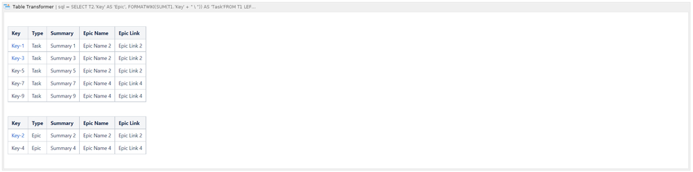

We've meant the screenshots of your full separate tables - I understood later that the third screenshot was a combination of your separate tables. The first row belongs to the first table and the second row - to the second table.

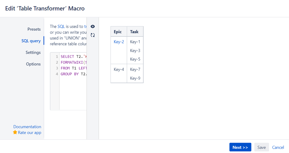

So, here is how I've got your case:
SELECT T2.'Key' AS 'Epic',
FORMATWIKI(SUM(T1.'Key' + " \\ ")) AS 'Task'
FROM T1 LEFT JOIN T* ON T1.'Epic Name' = T2.'Epic Name'
GROUP BY T2.'Key'

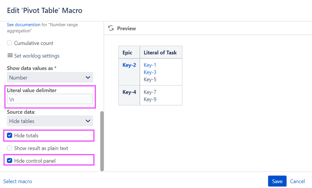

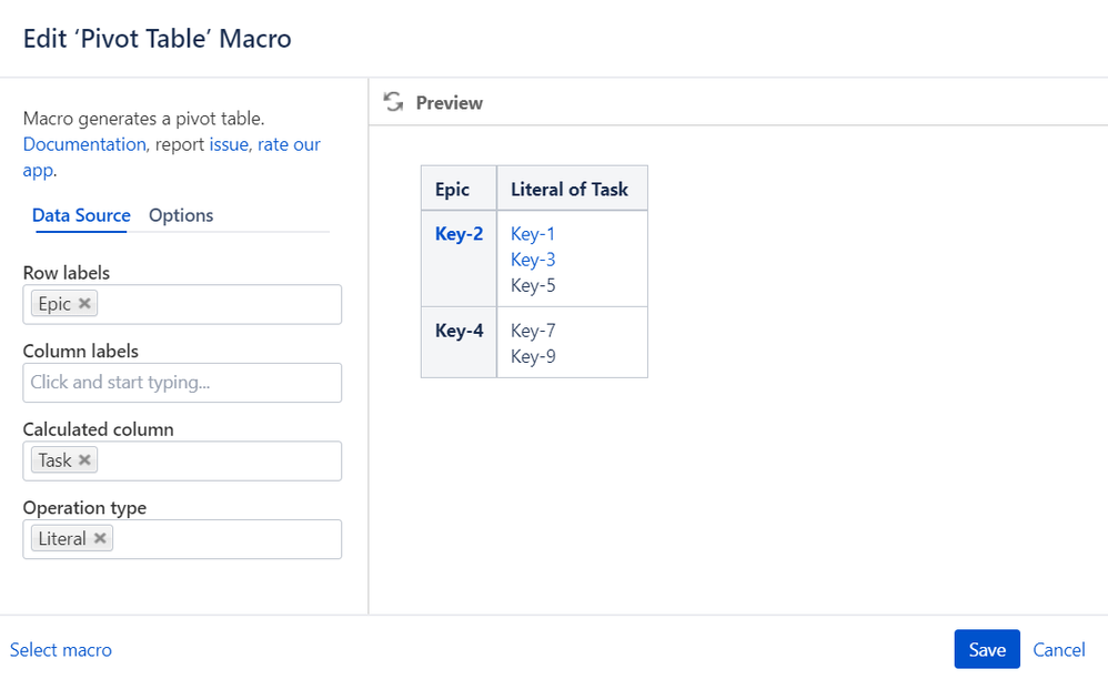

As you may notice, when we concatenate rows, the links are missing. So if you need links for your tasks, you may use the following workaround with the Pivot Table macro:
T1.'Key' AS 'Task'
FROM T1 LEFT JOIN T2 ON T1.'Epic Name' = T2.'Epic Name'
Now your links are present in both columns. And you may use additional Table Transformer macro to rename the second column in a prettier way if required.
Hope that this helps or at least gives you some ideas for the case.

T1 Definition
JQL: issuekey in (offers-6281)
Screenshot of table output:
T2 Definition
JQL: labels in (AlphaLiveData)
Output Based on Suggested SQL Query
SQL Query (adjusted since T1 has the Epic and T2 has the Task):
SELECT T1.'Key' AS 'Epic',
FORMATWIKI(SUM(T2.'Key' + " \\ ")) AS 'Task'
FROM T1 LEFT JOIN T* ON T2.'Epic Name' = T1.'Epic Name'
GROUP BY T1.'Key'
Screenshot of output:
Conclusion
Note that your question prompted me to output everything from the Jira Issue/Filters table to really analyze the data (thank you!) and I noticed an ampersand in the Epic Name. Removing the ampersand from the Epic Name resolved my woes. Wa-la!
