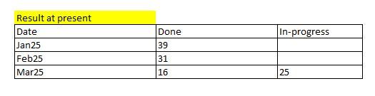

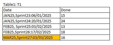

Hihi,
I had two tables as below(T1&T2), the date of both table is shown with "MMMYY,SPRINTxxx"(such as JAN25,Sprint23:06/01/2025), now i want the result display with Date MMMYY(such as Jan25) with the data of each month accordingly, order by MMMYY. i had tried the SQL below via using table transfomer in confluence, but it only show the data of T1 and Mar25 of T2, and did not show the DATA of Apr25 of T2, also the order is not sequence by data. Can somebody please help on it? Thank you so much.

Hi @Melbrin NGOUILOU_Andemex , thank you! I had tested the revised SQL, it works, now i can see the data of Apr also.
But there is another problem is that the order is not by 'Date', it shown like Feb25, Apr25, Jan25, Mar25, something like this. looks like the SQL below did not effective...any idea?
