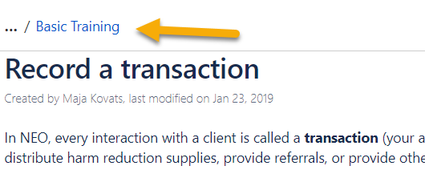

Now the breadcrumb menu follows you down the page as you scroll, i.e. it is fixed. This makes some content harder to read.
The breadcrumb menu doesn't seem to do this when the #header is not hidden.
I would like the breadcrumb menu to be relative.
I hope these images are illustrative:

Hello Maja,
Thank you for providing great detail into what you’re attempting to accomplish along with that you have done on the way. I went through your notes and screenshots and was able to replicate this on Confluence 6.14. I did find the cause of the stop space between scrolling down and up within a page. That space is due to the system add-on named Confluence Fixed Headers. I found attempting to adjust some of the settings were quickly ignored due to this add-on. More disabling this addon may be found at How to Disable Global Fixed Header in Confluence 5.9 and Above.
Alternatively, you may use a marketplace add-on to resolve this issue. A marketplace add-on will also ensure that your look and feel of Confluence will continue to work while being supported via the vendor. While your Javascript may work in this version, a future release may cause the script to break during an upgrade.
I hope this proves helpful in tailoring your content for anonymous users.

Hi Stephen,
Thank you for this solution, it does resolve the issue.
