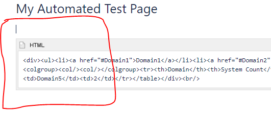

a HTML macro now inserted, with a html code body.

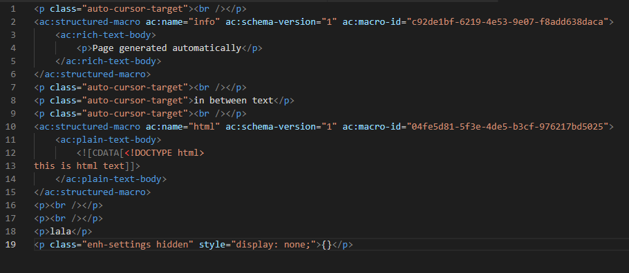

I also just now realise how easy it can be to find the "format" of other (any?) macros. You can just manually create the page with the macros you like, and "get" the page body from confluence using the api. something like this:
result = confluence.get_page_by_id(page_id, expand='body.storage', status=None, version=None)
The result variable is now carrying the HTML code in
result['body']['storage']['value']
 and it looks like this:
<p class="auto-cursor-target"><br /></p>
<ac:structured-macro ac:name="info" ac:schema-version="1" ac:macro-id="c92de1bf-6219-4e53-9e07-f8add638daca">
<ac:rich-text-body>
<p>Page generated automatically</p>
</ac:rich-text-body>
</ac:structured-macro>
<p class="auto-cursor-target">in between text</p>
<ac:structured-macro ac:name="html" ac:schema-version="1" ac:macro-id="04fe5d81-5f3e-4de5-b3cf-976217bd5025">
<ac:plain-text-body>
<![CDATA[<!DOCTYPE html>
this is html text]]>
</ac:plain-text-body>
<p><br /></p>
<p><br /></p>
<p>lala</p>
<p class="enh-settings hidden" style="display: none;">{}</p>
with code highlighting is becomes clear:
Maybe this helps someone else too 😅
