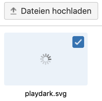

1. When I add a SVG file over "Add image/file" the import keeps showing the import wheel:
2. Nevertheless the "Insert" button gets activated. So I press it.

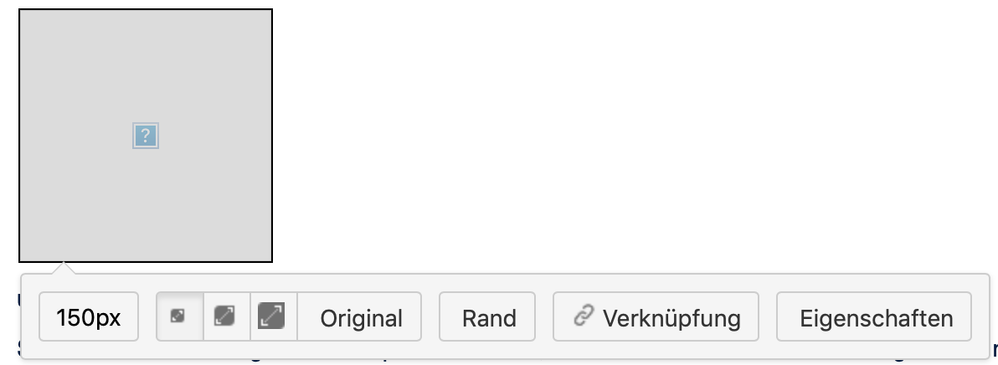

4. When I change the size of the image either by entering a specific size or by one of the three default size buttons, then the SVG file in the document shows a broken link:

Hello there!
You are right, there is a bug report tackling this behaviour. We can check it here:
CONFSERVER-40672 | Confluence File Preview does not allow setting custom size for SVG format
The trick here is that you can resize the image down to 301px. Any lower than that and the image will break.
A good approach would be to vote and watch this report. Voting increases the report visibility and watching will keep you up to date!
