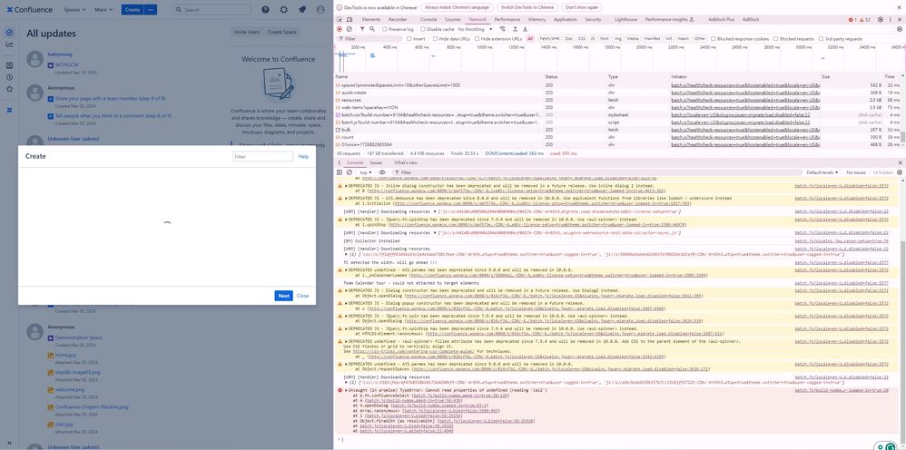

Moreover please try to open developer ui in your browser and provide us information about some error at network side during a rest api call

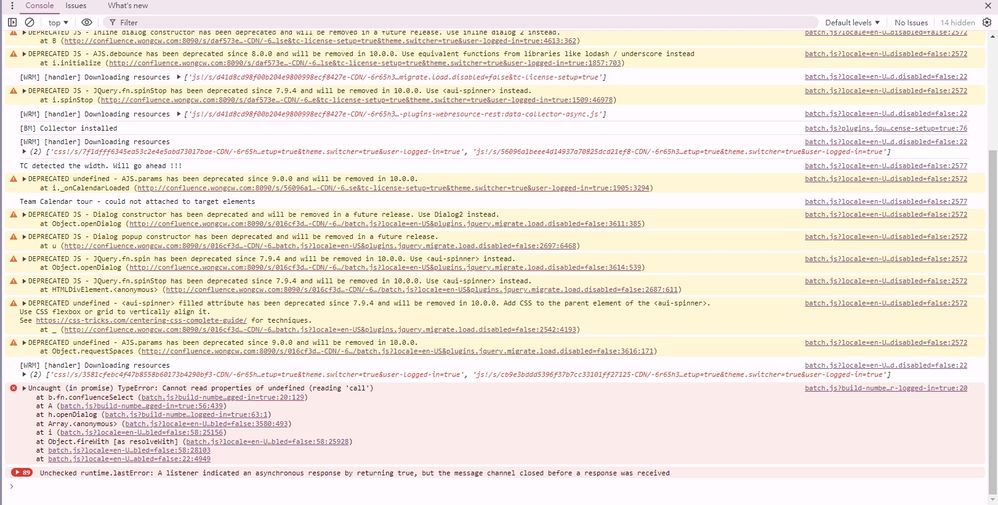

[WRM] [handler] Downloading resources (2) ['css!/s/3581cfebc4f47b8558b60173b4290bf3-CDN/-6r65h…etup=true&theme.switcher=true&user-logged-in=true', 'js!/s/cb9e3bddd5396f37b7cc33101ff27125-CDN/-6r65h3…etup=true&theme.switcher=true&user-logged-in=true'] batch.js?build-number=9104&healthcheck-resources=true&hostenabled=true&locale=en-US&plugins.jquery.migrate.load.disabled=false&tc-license-setup=true&theme.switcher=true&user-logged-in=true:20 Uncaught (in promise) TypeError: Cannot read properties of undefined (reading 'call') at b.fn.confluenceSelect (batch.js?build-number=9104&healthcheck-resources=true&hostenabled=true&locale=en-US&plugins.jquery.migrate.load.disabled=false&tc-license-setup=true&theme.switcher=true&user-logged-in=true:20:129) at A (batch.js?build-number=9104&healthcheck-resources=true&hostenabled=true&locale=en-US&plugins.jquery.migrate.load.disabled=false&tc-license-setup=true&theme.switcher=true&user-logged-in=true:56:439) at h.openDialog (batch.js?build-number=9104&healthcheck-resources=true&hostenabled=true&locale=en-US&plugins.jquery.migrate.load.disabled=false&tc-license-setup=true&theme.switcher=true&user-logged-in=true:63:1) at Array. (batch.js?locale=en-US&plugins.jquery.migrate.load.disabled=false:3580:493) at i (batch.js?locale=en-US&plugins.jquery.migrate.load.disabled=false:58:25156) at Object.fireWith [as resolveWith] (batch.js?locale=en-US&plugins.jquery.migrate.load.disabled=false:58:25928) at batch.js?locale=en-US&plugins.jquery.migrate.load.disabled=false:58:28103 at batch.js?locale=en-US&plugins.jquery.migrate.load.disabled=false:22:4949 b.fn.confluenceSelect @ batch.js?build-number=9104&healthcheck-resources=true&hostenabled=true&locale=en-US&plugins.jquery.migrate.load.disabled=false&tc-license-setup=true&theme.switcher=true&user-logged-in=true:20 A @ batch.js?build-number=9104&healthcheck-resources=true&hostenabled=true&locale=en-US&plugins.jquery.migrate.load.disabled=false&tc-license-setup=true&theme.switcher=true&user-logged-in=true:56 h.openDialog @ batch.js?build-number=9104&healthcheck-resources=true&hostenabled=true&locale=en-US&plugins.jquery.migrate.load.disabled=false&tc-license-setup=true&theme.switcher=true&user-logged-in=true:63 (anonymous) @ batch.js?locale=en-US&plugins.jquery.migrate.load.disabled=false:3580 i @ batch.js?locale=en-US&plugins.jquery.migrate.load.disabled=false:58 fireWith @ batch.js?locale=en-US&plugins.jquery.migrate.load.disabled=false:58 (anonymous) @ batch.js?locale=en-US&plugins.jquery.migrate.load.disabled=false:58 (anonymous) @ batch.js?locale=en-US&plugins.jquery.migrate.load.disabled=false:22 Promise.then r.done @ batch.js?locale=en-US&plugins.jquery.migrate.load.disabled=false:22 L @ batch.js?locale=en-US&plugins.jquery.migrate.load.disabled=false:58 when @ batch.js?locale=en-US&plugins.jquery.migrate.load.disabled=false:58 Confluence.Blueprint.loadDialog @ batch.js?locale=en-US&plugins.jquery.migrate.load.disabled=false:3580 (anonymous) @ batch.js?locale=en-US&plugins.jquery.migrate.load.disabled=false:3581 dispatch @ batch.js?locale=en-US&plugins.jquery.migrate.load.disabled=false:58 v.handle @ batch.js?locale=en-US&plugins.jquery.migrate.load.disabled=false:58 89Unchecked runtime.lastError: A listener indicated an asynchronous response by returning true, but the message channel closed before a response was received

HaleyWong September 20, 2024
The latest version, after installing and entering the platform, this is the situation, did not do any settings, did not install any plug-ins.
