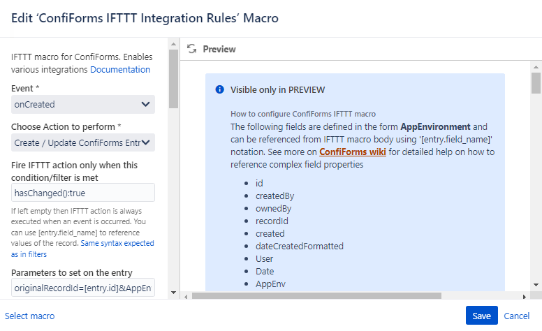

1. people mostly use IFTTT macros for that but I tried that and dont see anything changing for my template page nor the result page (screenshot for an IFTTT macro below)

- IFTTT macro (from the picture) is inside ConfiForms Form Definition Body on Template page
- Parameters to set on the entry: originalRecordId=[entry.id]&AppEnv=[entry.AppEnv]&AppEnv2=[entry.AppEnv2]&myuser=[entry.myuser]

f. IFTTT Macro - onCreated - Action: Audit (the macro body is empty though)
