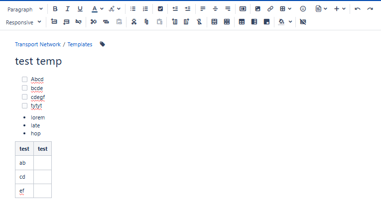

I have created a template in confluence navigation to this path is Space tools->Content tools->templates
I have added check boxes and some sample content in the template the below screenshot is before saving the template.
When I try to edit the same template lot of content is missing-Is this the by default functionality of Confluence or can I resolve this issue by doing any work around

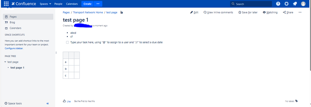

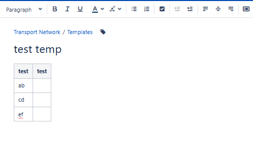

The issue here is if I try to edit the template the data is getting missed,but if I create the page using the template I am getting complete data like bullet points,checkboxes everything
please refer to the attached screenshots:
page created using the template
template when I try to edit it
Please let me know should I share any other details
I know exactly what you are referring to. When you create a new page using your template you can see the features yo added to the template. When you try to edit the template itself to make adjustments to it you don't see the layout you created.

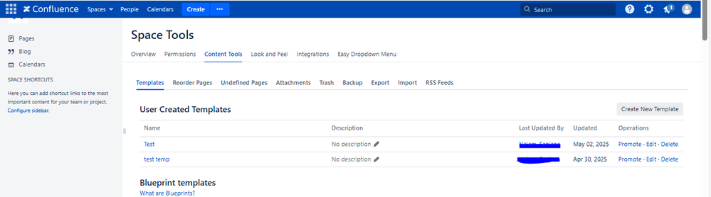

I have admin access to confluence and I have tried finding the user created template in the global templates.
I am trying to edit the templates inside the space because the templates are user templates
Also I cannot find these templates in the global templates in the general configuration
