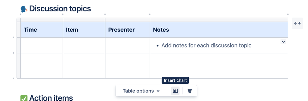

It looks like you're using the old Chart macro (which I hope is going away). To use the new chart feature, you should be able to select you table, and then in the table options menu, you can select "Insert Chart".
Does this work for you?
Thanks This sounds a lot simpler but I can't seem to access the Table options menu !
