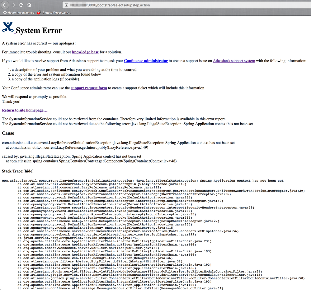

directory, Build Index has been selected, next during one minute when I did try to found file in window below by clicking into No file ...lala-lala, I saw message with error. Take a look on a picture below:
Then I did try restart service for my try to do it again. I had meet up with new error message in my web browser.

A system error has occurred — our apologies!
For immediate troubleshooting, consult our knowledge base for a solution.
If you would like to receive support from Atlassian's support team, ask your Confluence administrator to create a support issue on Atlassian's support system with the following information:
Your Confluence administrator can use the support request form to create a support ticket which will include this information.
We will respond as promptly as possible.
Thank you!
The SystemInformationService could not be retrieved from the container. Therefore very limited information is available in this error report.
The SystemInformationService could not be retrieved due to the following error: java.lang.IllegalStateException: Spring Application context has not been set
com.atlassian.util.concurrent.LazyReference$InitializationException: java.lang.IllegalStateException: Spring Application context has not been set
at com.atlassian.util.concurrent.LazyReference.getInterruptibly(LazyReference.java:149)
caused by: java.lang.IllegalStateException: Spring Application context has not been set
at com.atlassian.spring.container.SpringContainerContext.getComponent(SpringContainerContext.java:48)

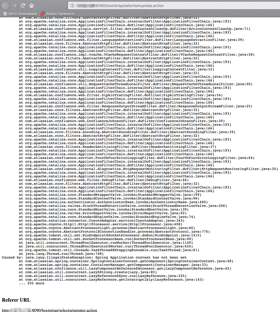

com.atlassian.util.concurrent.LazyReference$InitializationException: java.lang.IllegalStateException: Spring Application context has not been set at com.atlassian.util.concurrent.LazyReference.getInterruptibly(LazyReference.java:149) at com.atlassian.util.concurrent.LazyReference.get(LazyReference.java:112) at com.atlassian.confluence.setup.webwork.ConfluenceXWorkTransactionInterceptor.getTransactionManager(ConfluenceXWorkTransactionInterceptor.java:29) at com.atlassian.xwork.interceptors.XWorkTransactionInterceptor.intercept(XWorkTransactionInterceptor.java:56) at com.opensymphony.xwork.DefaultActionInvocation.invoke(DefaultActionInvocation.java:165) at com.atlassian.confluence.xwork.SetupIncompleteInterceptor.intercept(SetupIncompleteInterceptor.java:52) at com.opensymphony.xwork.DefaultActionInvocation.invoke(DefaultActionInvocation.java:165) at com.atlassian.confluence.security.interceptors.SecurityHeadersInterceptor.intercept(SecurityHeadersInterceptor.java:39) at com.opensymphony.xwork.DefaultActionInvocation.invoke(DefaultActionInvocation.java:165) at com.opensymphony.xwork.interceptor.AroundInterceptor.intercept(AroundInterceptor.java:35) at com.opensymphony.xwork.DefaultActionInvocation.invoke(DefaultActionInvocation.java:165) at com.atlassian.confluence.setup.actions.SetupCheckInterceptor.intercept(SetupCheckInterceptor.java:27) at com.opensymphony.xwork.DefaultActionInvocation.invoke(DefaultActionInvocation.java:165) at com.opensymphony.xwork.DefaultActionProxy.execute(DefaultActionProxy.java:115) at com.atlassian.confluence.servlet.ConfluenceServletDispatcher.serviceAction(ConfluenceServletDispatcher.java:56) at com.opensymphony.webwork.dispatcher.ServletDispatcher.service(ServletDispatcher.java:199) at javax.servlet.http.HttpServlet.service(HttpServlet.java:741) at org.apache.catalina.core.ApplicationFilterChain.internalDoFilter(ApplicationFilterChain.java:231) at org.apache.catalina.core.ApplicationFilterChain.doFilter(ApplicationFilterChain.java:166) at org.apache.tomcat.websocket.server.WsFilter.doFilter(WsFilter.java:53) at org.apache.catalina.core.ApplicationFilterChain.internalDoFilter(ApplicationFilterChain.java:193) at org.apache.catalina.core.ApplicationFilterChain.doFilter(ApplicationFilterChain.java:166) at com.atlassian.confluence.web.filter.DebugFilter.doFilter(DebugFilter.java:46) at com.atlassian.core.filters.AbstractHttpFilter.doFilter(AbstractHttpFilter.java:32) at org.apache.catalina.core.ApplicationFilterChain.internalDoFilter(ApplicationFilterChain.java:193) at org.apache.catalina.core.ApplicationFilterChain.doFilter(ApplicationFilterChain.java:166) at com.atlassian.plugin.servlet.filter.ServletFilterModuleContainerFilter.doFilter(ServletFilterModuleContainerFilter.java:51) at com.atlassian.plugin.servlet.filter.ServletFilterModuleContainerFilter.doFilter(ServletFilterModuleContainerFilter.java:45) at com.atlassian.johnson.plugin.servlet.filter.JohnsonServletFilterModuleContainerFilter.doFilter(JohnsonServletFilterModuleContainerFilter.java:50) at org.apache.catalina.core.ApplicationFilterChain.internalDoFilter(ApplicationFilterChain.java:193) at org.apache.catalina.core.ApplicationFilterChain.doFilter(ApplicationFilterChain.java:166) at com.atlassian.confluence.util.message.MessagesDecoratorFilter.doFilter(MessagesDecoratorFilter.java:64) at com.atlassian.core.filters.AbstractHttpFilter.doFilter(AbstractHttpFilter.java:32) at org.apache.catalina.core.ApplicationFilterChain.internalDoFilter(ApplicationFilterChain.java:193) at org.apache.catalina.core.ApplicationFilterChain.doFilter(ApplicationFilterChain.java:166) at com.opensymphony.sitemesh.webapp.SiteMeshFilter.doFilter(SiteMeshFilter.java:65) at com.atlassian.confluence.util.profiling.ProfilingSiteMeshFilter.doFilter(ProfilingSiteMeshFilter.java:50)
HALF OF THIS LOG is deleted due restriction to this message in 20,000 characters.
http://local_IP_Address:8090/bootstrap/selectsetupstep.action
