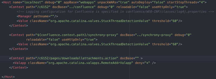

I've had a look at the workaround you mention, but I see that it doesn't mention to replace any lines, but to add it to the <Host> element.
You should already have some existing Context paths there, but don't modify those, just add the new lines inside of the <Host> element.
So mine looks like this:
Of course, if you are using a context path, you need to adjust it to your own, but the goal is to have it as another item in the <Host> element.
Can you give that a try and let me know how it goes?
