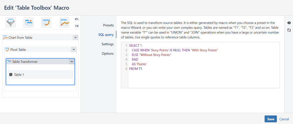

Then go to the Table Toolbox settings and wrap you table (Jira Issues macro for your case) into the Table Transformer macro and use the following custom SQL query:
SELECT *,
CASE WHEN 'Story Points' IS NULL THEN "With Story Points"
ELSE "Without Story Points"
END
AS 'Points'
FROM T1

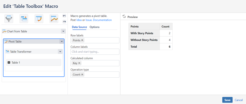

Then wrap your Table Transformer in the Pivot Table macro:

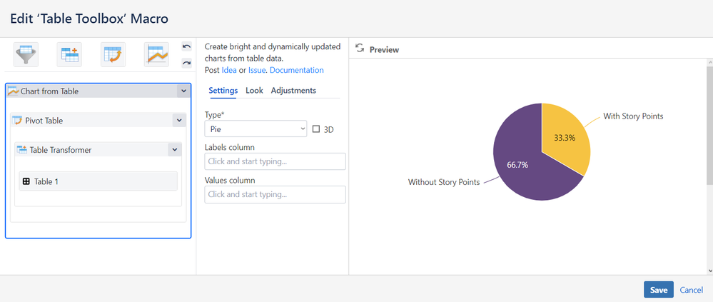

The last step is to visualize your pivot with the help of the Chart from Table macro:
Hope this may help your case.
