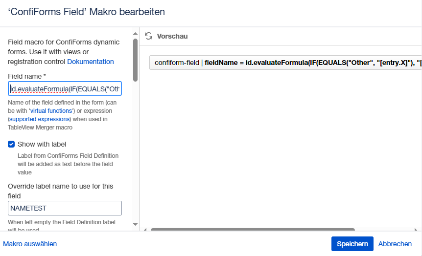

I have put this in the field name, as you said:

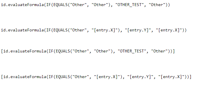

This doesn't work, these are the lines shown on my page:

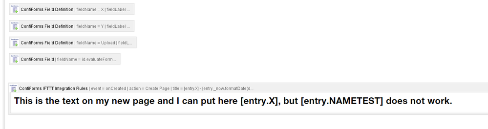

In my Confi Form:

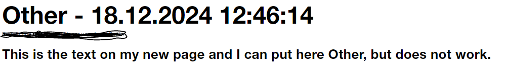

On my resulting page:
I want to know what I need to put instead of [entry.NAMETEST]
On my Main page i have this:
But I'm unsure what to put here instead of [entry.NAMETEST] so that I get the result of the virtual function on my new page:
As shown in my previous picture, NAMETEST is the "Override label name to use for this field" for my virtual function.
As shown in my previous picture, it is the "Override label name to use for this field" for the virtual function ConfiForms field element.
As shown in my previous picture, it is the "Override label name to use for this field" for the virtual function ConfiForms field element... is this the wrong approach?
