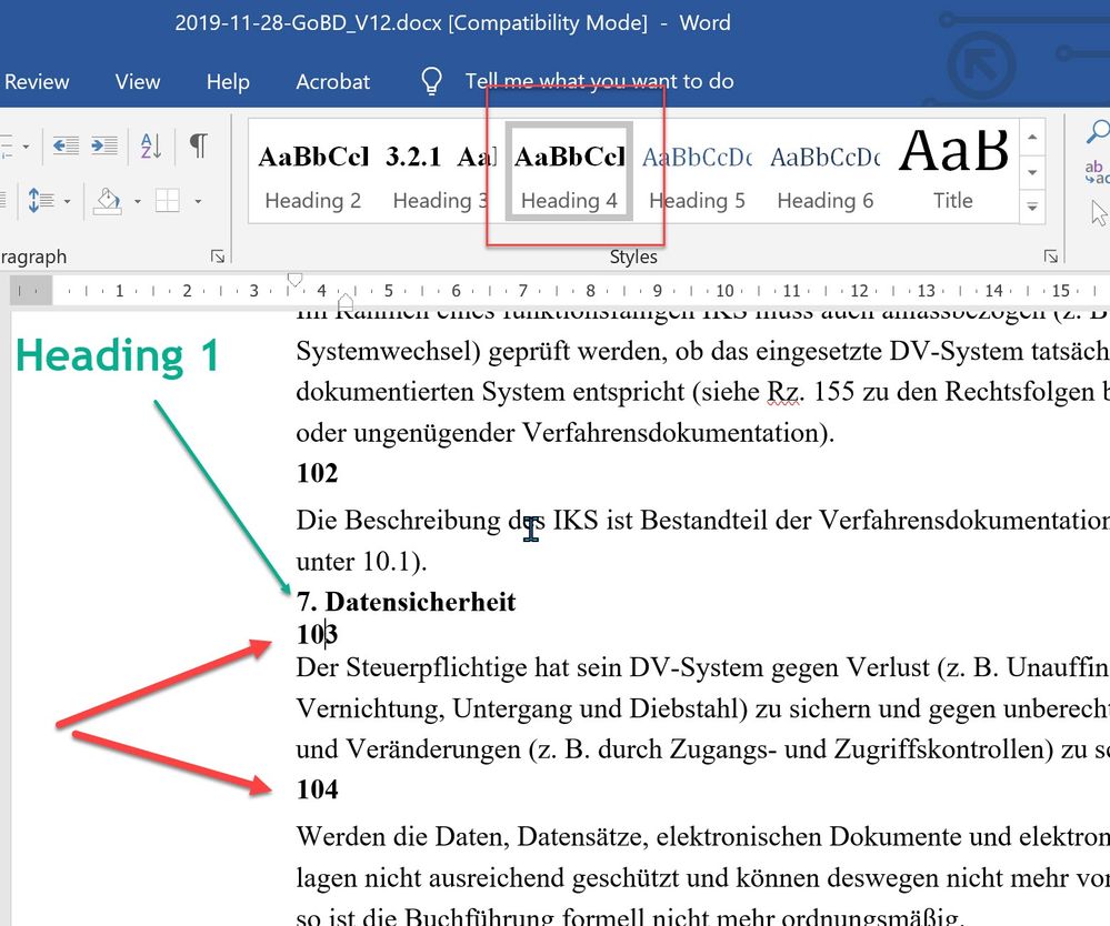

I have a Word document with Heading levels 1,2,3 and 4.  Import with split 1,2,3  works identically, splitting by Heading 4.

Michel
February 1, 2021
Hi @Shannon S
the issue is not regarding level 4. The issue is , that the splitting on level 1 and 2  doesn't work at all.   The document will be splited on the level 4. I dont need it . I want to separate on level 2.
The system ignore the setting (level 1,2,3) .
Warm regards Michel

Michel
February 3, 2021
Hi @Shannon S ,
thanks a lot for your effort ! I found out, what causes the issue: In my document are gaps between the headings. That means, under Heading 1 are only Headings 4. In my document ii is not an bug, it mus be so. The Heading 4 is a ortogonal, independent "labels".   I close the qestion, because it is not a normal use case.
Thansk again,
Michel

Confluence Administrator June 25, 2021
i have a similar issue. My headings in Word are H1, H2, H3 and H4. I have set the Word headings so they should split pages/child pages after import. Headings that i didnt want to affect new page creation i set to H4
When i try import, setting level 1+2, it imports H1 and H2 from Word.
But when i set level 1+2+3, it imports down to level H4 of Word, making more child pages that i want. I actually need it to import down to H3 of Word but this just isnt working correctly.
Why does it not respect the heading hierarchy? This is my first experience with Confluence and is proving to be difficult, especially after spending a day changing headings in a 800 page document so that it 'should' import correctly.
Would appreciate comments.
Oh, it may well be the case that i have a heading H2 followed by H4 on pages.
