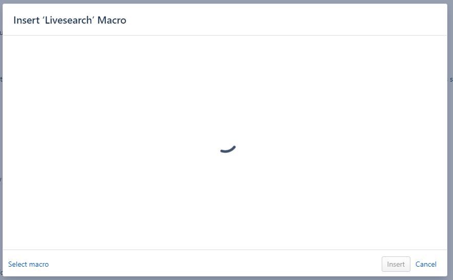

Arek Jarosiewicz December 5, 2019
Shannon I have attached a screen-shot below from which you can see that it stuck in an infinitive loading loop forever.
I have checked the console log and above error is displayed.
