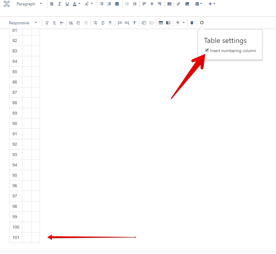

Hello all. I am using Confluence Cloud and I still see this issue. I have attached a screenshot.
@Damien Tan: How did you get the column to adjust to 2-digit and 3-digit numbers? Can you please try it again on Confluence Cloud? Thank you.

hey @Rajat Srivastav
I was focusing on Confluence Server and my screenshot above was taken from a Confluence Server v6.7.2
However, I just tried replicating the same thing in a Confluence Cloud instance and I can see the same outcome as well:
table numbering.png I simply opened a blank page and insert a table and then enable Insert numbering column to my table. then hold down the TAB button to make it all the way to row 100, it was able to expand whenever it hit more digits.
Perhaps you can do the same test on a new page and see if this works on your end?

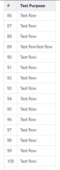

Hey @Casey Maynard
if I got your problem right, the column in your table that is inserted using Insert Numbering Column feature is not in the correct width to display the row number
I've tried to insert a dummy table in my Confluence 6.7.2 with some simple test data just to make sure the table has enough rows to test this out, and the result that I got seems to be just fine. You won't be able to edit the width of the numbering column regardless if you set the table to Responsive or Fixed width because this particular column would automatically adjust its width to fit the row number's length (at least that is what I can see when I test it up to 3 digits). Here is the example of my table:
As you can see, the numbering row expand itself to be able to display 3 digits.
I wonder what is the Confluence version you're using and if you can show me a screenshot of the issue?
