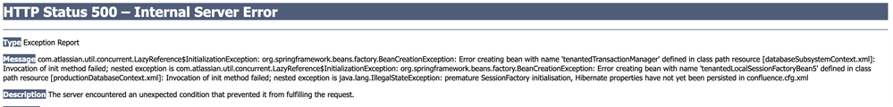

Hello Jay
Thank you for your help,I tried your method,and sure it can resolved su: System error.But when I want to setup confluence after config the DB. it comes another error.
Also i tried another way that write "USER confluence" into docker file and use
"oc new-app --docker-image=" to create pod. This way also can reslove su: System error.But also meet the error which is in the picture.
So if u konw the solution pls tell me.
Thank you
