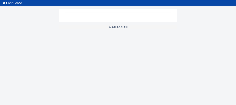

The follow screenshot is the brower, can see nothing when I click the Next button.

Fabio Racobaldo _Catworkx_
December 5, 2022
Hey @Tom L ,
I just found this bug https://jira.atlassian.com/browse/CONFSERVER-59387
Try to ignore and go ahead as specified in the provided link.
Fabio
