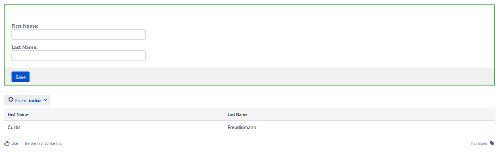

Here is the result I see

Hey Alex, thanks for the response. I have tried using the CSS Rules for Fields and have tried to match up what I have with the given example. I am unable to get my CSS to apply to a tableview or calendarview.
I have my form which displays the entries to the table and to the calendar correctly. I can add the CSS Rule for Field and I enter the field i want and add a condition like myField:*1 to match anything in that field that ends with the number 1. And if it does match to change the background color to green.
I could provide storage format if necessary.
Well, please have look at the page I have shared with you and see what YOU are missing. The example shows you where to put the macro and where to write the CSS (also, it tells you that !important is required when you work with CalendarView entries)
Yes Alex I have viewed this page and I was already using the !Important.. I even built a brand new form and TableView to try and get this to work. I believe to have this set up nearly the same as the example. (The only difference I see is the naming of macros.. which I believe have changed over time.
Please view screenshots
This screenshot shows how I have the form set up.
This screenshot shows how I have the Rules set up.
This screenshot shows the page with no CSS applied.
Thanks for your time!
